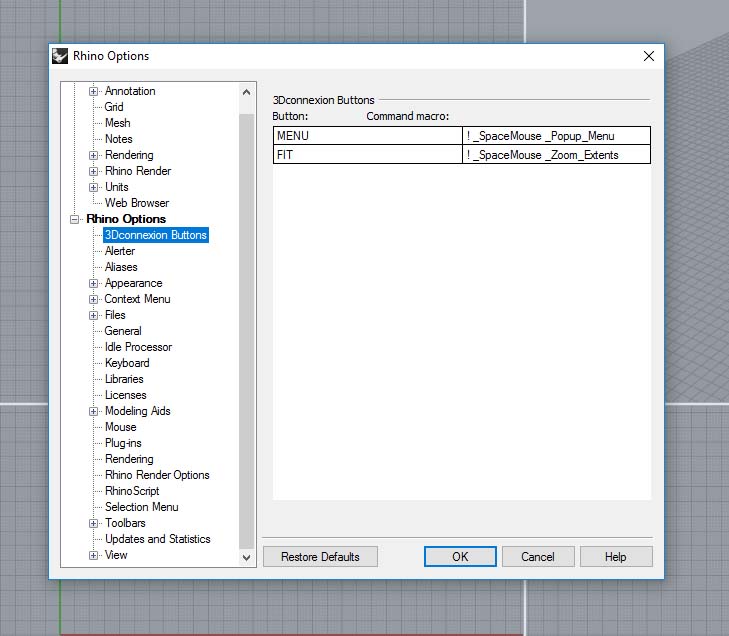

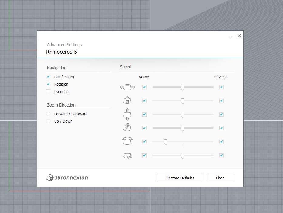

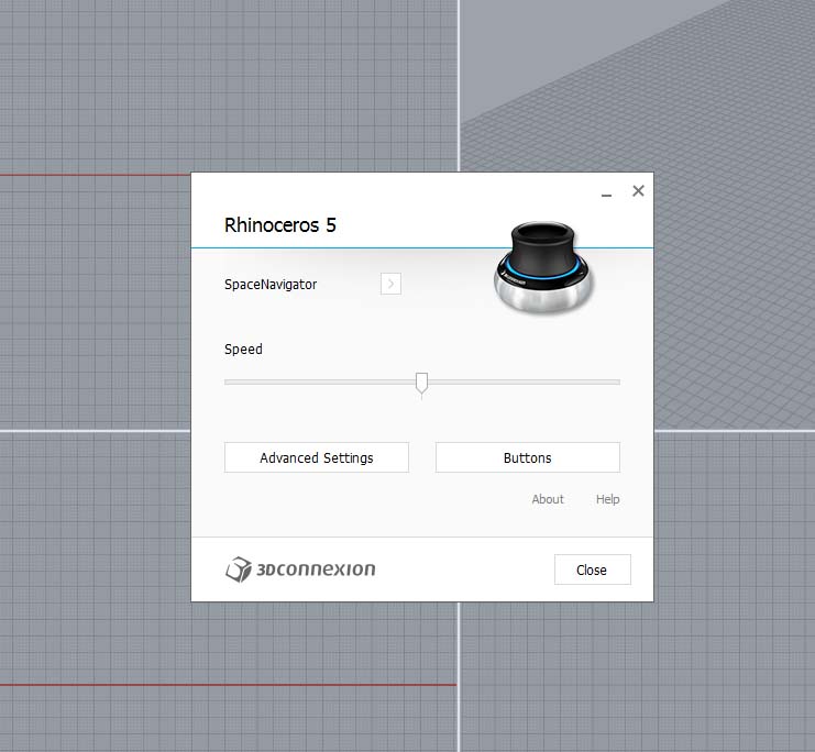

Hello,
I have a space navigator that I use with Rhino 5. I am running windows 10 and the latest 3d connection software/driver. I have searched online exhaustively to find out how to lock the horizon. I found this advice in one the threads on this forum:
"In Rhino V5 the Rhino profile has a button mapped to the 3d navigation options. The left SpaceNavigator button is mapped to Rhino's pop-up menu with options to Lock Horizon and choose Camera or Helicopter Mode
Also in Rhino Options under "Tools -> Options -> Rhino Options -> View you can choose Rotate around world axes or Rotate relative to view."
None of this correlates with my experience. Please see attached screens. I have everything working how I want, except for LOCK HORIZON. WHERE IS IT???
Thanks for your help,
David

please try the following: in the 3Dconnexion properties window open the Buttons and click to "Restore Defaults". See if this helps. From your screenshot (rhino screen 3.jpg) the command in the Rhino Options is correct.

Thanks, but this is not what I am looking for. Restoring defaults just does exactly that. I am looking for a LOCK HORIZON option as there has been in the past. I had to go into advanced options and reverse all the directions in order to get it close to what I am used to (which is a helicopter mode with a locked horizon). Restore defaults just un-reverses everything.UtaSH wrote:Hi David,
