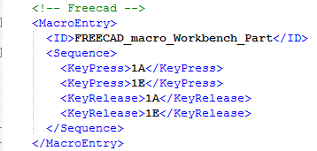

Hello,
I'm new to the 3Dconnexion Forum. I recently bought a SpaceMouse Enterprise.
Now I'm on getting Pictures to my macros for FreeCad.
I followed your instructions. My macro is working, but i dont get the Picture to show up.
So here is what i did:
I'm in Germany so C:\Program Files\3Dconnexion\3DxWare?3DxWinCore64\Cfg\de-DE.xml
declared a string for my Button
declared my macro in the macrotable
C:\Program Files\3Dconnexion\3DxWare?3DxWinCore64\Cfg\Global.xml
did my ButtonFlyouts with a new Category (works)
%appdata% /3dconnexion/3DxWare/Cfg/FreeCAD.xml
declared my ButtonActions with a .png shipped bye 3Dconnexion right bevore the macrotable. I'm not allowed to do one more picture so I'll post code:
<ButtonActions xmlns:driver_images="./Images/3DxService/">
<!-- Keyboard Functions -->
<ButtonAction Type="Macro">
<ID>FREECAD_macro_Workbench_Part</ID>
<Name>FREECAD_str_Workbench_Part</Name>
<Image>
<Source>[driver_images:Generic_Extrude.png]</Source>
</Image>
</ButtonAction>
</ButtonActions>
And that's it all i did. I can use the command. It's working, but it doesn't show the picture just the string, that i declared on my mouse.
Hope you can help me.
Stephan
<Image>
</Image>
</ButtonAction>
</ButtonActions>
Stephan

Re: SpaceMouse Enterprise Kit with my software...
Oh man I'm so stupid...
The Images are in the Programm folder, but you need it where your FreeCAD.xml is.
youst copied the images folder from
C:\Program Files\3Dconnexion\3DxWare\3DxWinCore64\Cfg
to
and the Image is imediately appearing.
to
