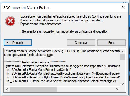

Hi i have a problem with my SPacemouse Wireless. I got the new driver 10.5.1 when i use it in SOLIDEDGE ST9 , when i set a custom radial menu it doesnt set and keep the new setting. And if i try to modify a my profile created before , i got the errore that you can see as attachment. I also tried to unistall and reinstall , doesnt change anything.
I work with Windows 10 , SolidEdge ST9 , INTEL I7 7740 , AMD RX 470 8gb GDDR ( driver version 17.8.2).
Can some one help me , please ?

Hello Luca,
I apologize for the trouble you encounter. Please clean your settings as described here and try again. In case you still get problems please get in contact with our Technical Support Team.
