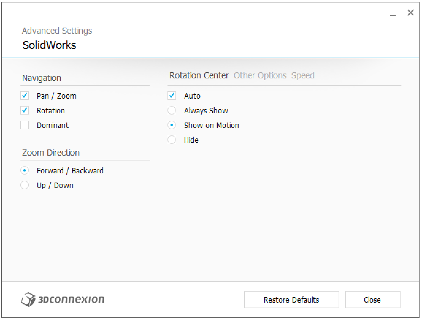

After updating to the latest release of the 3D connection software I have had an issue with solidworks
Solidworks until recently had an extra options tab that would allow me to "zoom to cursor"
The tabs that are shown in the help document below are missing. The only Tab I have is Speed.
Solidworks 2018 SP1
3Dx Ware 10.5.4
3Dx WinCore 17.5.4.14569
UtaSH
Posts: 3754
Location: Munich, Germany
Re: Space Mouse Solidworks Missing Settings
Post by UtaSH »
Hello michaeld,
it seems that the plugin isn't loaded in SolidWorks. Please check this FAQ. It might be that you are staring SolidWorks and the driver with different user levels.
michaeld
Posts: 3
Joined: Fri Jan 26, 2018 9:59 am
Post by michaeld »
Thanks for the response.
I reverted back to the previous driver and things started working again, both Drivers are on the same level.
I will update 3dx again and see if this changes.
