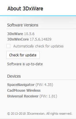

Good afternoon,
I just received a new HP Workstation running Windows 10 64bit. The Space Navigator works in Rhino6, Spinfire Ultimate, and NX11.01, but does not respond at all in CATIA V5R26. My Windows 7 Workstation had no issues in CATIA, and this is the first I have encountered anything like this. I have attached a picture of the drivers that are being used.
We have uninstalled and re-installed the drivers.
We have turned off the firewall.
All with no luck. Thank you for any help.

Hello cpierlacks,
can you please try a previous version of the driver - 3DxWare 10.5.3. You can find it in our driver archive . Note that you have to uninstall the newer version of the driver before you install the older one.
Please let us know what you find out.
