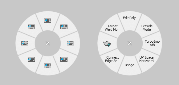

Then finally I would like to ask whether it's possible to rename radial menu items? Macro's can be named, however in the radial menu they are listed with a keyboard logo. If I were to choose a native supported action, for instance Turbosmooth in 3Ds Max, it shows up as Turbosmooth in the radial menu. The right hand radial menu is obviously superior to the left one in terms of ease of use.

3 Not sure whether supported, but allow the macro name to be reported within the radial menu (instead of showing the keyboard icon and only reporting the name when hovering over an item).

1 Allow macro names to be reported in the radial menu (without having to customize XML files)
Allow custom icons to be added, so that users can create macro's, thereby adding their own programs.

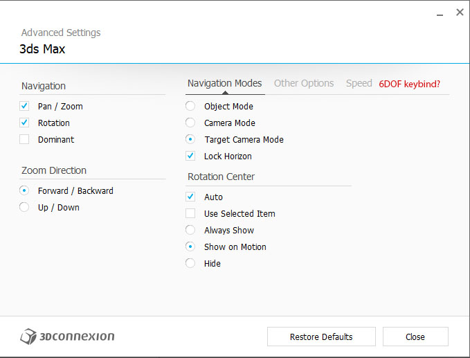

3 Especially for 2D software, such as Photoshop and Illustrator, add the option to bind rotation axis input to macro's, with the speed registering as how often the macro gets executed. I would put it in a tab such as the one listed in the picture below located in advanced settings.
