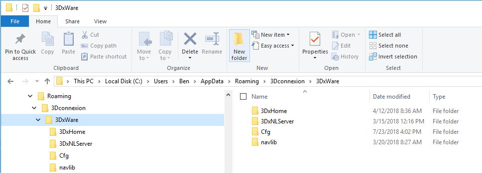

I made it to appdata however in my install I see under the 3DxWare directory only 4 sub-directories named:3DxHome, 3DxNLServer, Cfg, navlib. Those directories have only .xml files and navlib has .config files. I could not find any .log file anywhere.
Bax
Bax
Re: Ctrl+scroll whell does not zoom in chrome or edge
As you can see there is no log file anywhere and those sub-directories contain only .xml files or .config files
(or I'm totally out of left field)
Go to %localappdata%\3Dconnexion\3DxWare. This would be in your case C:\Users\Ben\AppData\Local\3Dconnexion\3DxWare.
