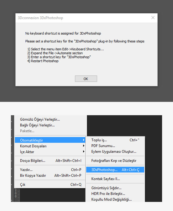

I installed 3dconnexion version 10.5.12. I opened Photoshop and this warning came up. I wrote this shortcut. I come across this warning every time I open Photoshop. Is there a way to shut this down?

Re: Photoshop CC 2019
Hello vduvencioglu,
please contact our Technical Support Team. They can do the necessary troubleshooting and escalate to the next level of expertise if needed.
