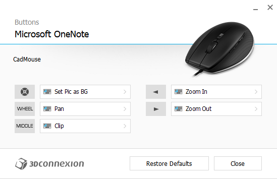

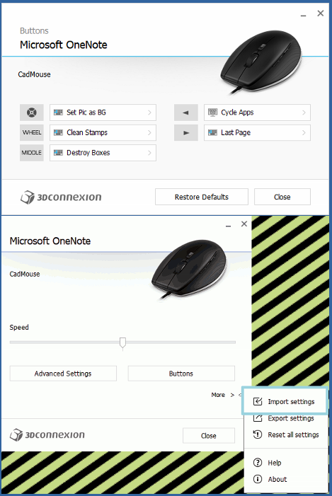

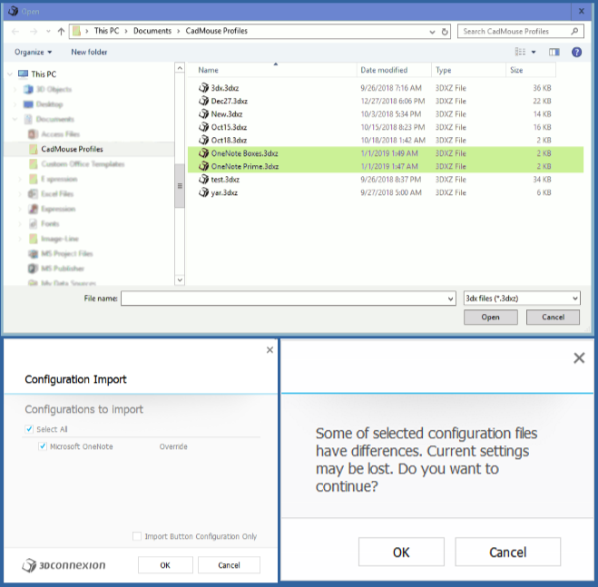

It is helpful to have multiple profiles setup for certain applications that are context-driven.
I am wondering what methods are available to quickly change a profile, hopefully in one to two clicks.
It can be a moderate inconvenience to switch profiles for a single program, while making sure you don't accidentally import new configs for all of your other apps.
Current process: 1) Open 3DConnexion Properties > 2) Select "More" > 3) Select Import Settings > 4) Choose File > 5) Confirm Config > 6) Click-through warning > Done
