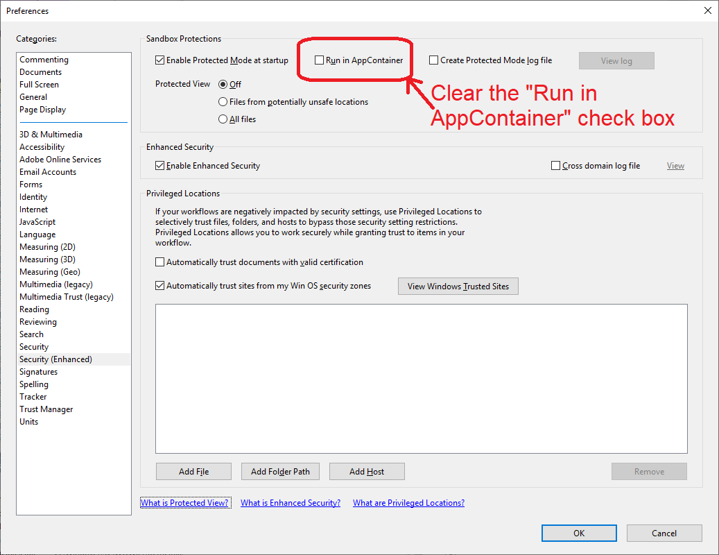

A workaround from AnandSri Adobe Staff via erikbak's link seems to work for me so far:
Disable the 'Protected mode at startup' in Adobe Reader's Preferences from Edit>Preferences>Security(Enhanced)>Disable this option>click OK>restart the application.

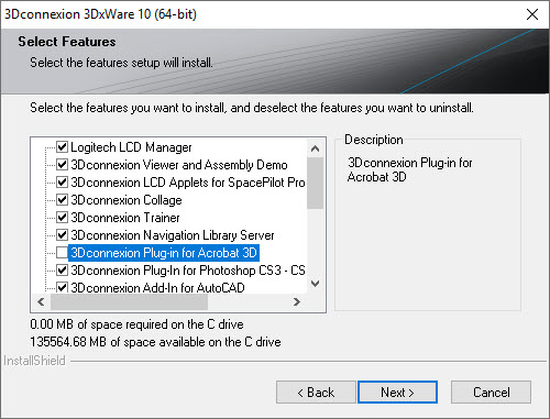

I apologize the trouble you encounter with the Adobe Reader. We are aware about this issue and we are tracking it with our internal Bug number WIN-297.
As a workaround you can unistall the plugin for Adobe Acrobat 3D. Go to “Programs and Features” and “Change” the installation of the “3Dconnexion 3DxWare”.

One other alternative appears to be disabling the "Run in AppContainer" option in the Reader preferences panel.
We believe a recent udpate to Reader has enabled this option by default. With the application running in an "AppContainer", the add-in is enable to reach the driver although it can still detect it, causing the errors you are experience.
We are sorry for the inconvenience this issue is causing to our costumers. We're looking into what we can do to resolve this issue (without having to resort to disabling a security feature of Reader).

We still don't have the full picture but we can see the delay using an older build of our software (v. 10.5.12). With the newest driver (included in v. 10.5.13), we see the error message boxes. These are catching the earlier problem that caused the delay.
In all our scenarios, disabling the "Run in AppContainer" option prevents both the delay and the message boxes but this will reduce the security level Reader will run at.
