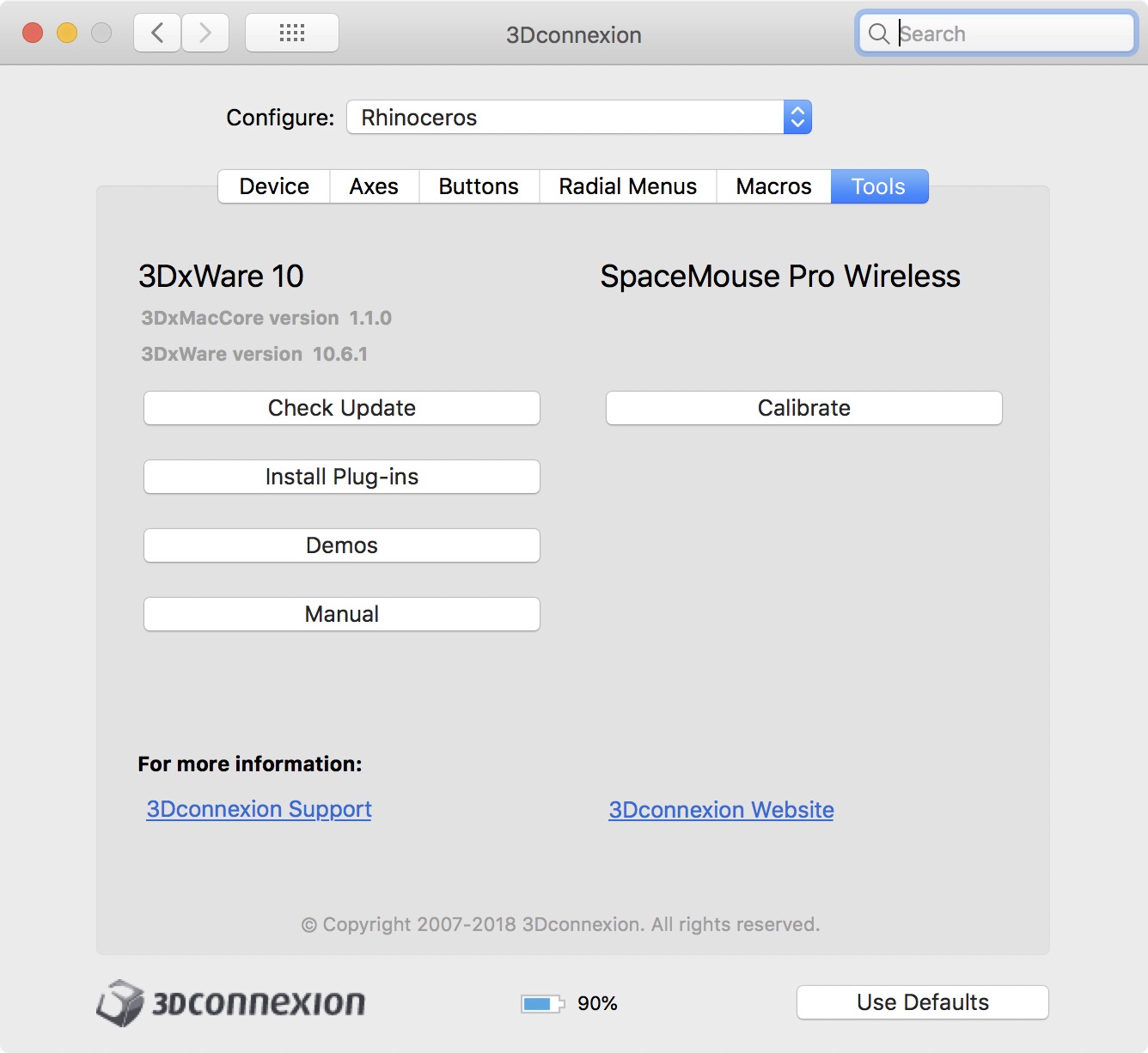

I am using Rhino 5 for Mac.
Attached is the specs of the installed driver.

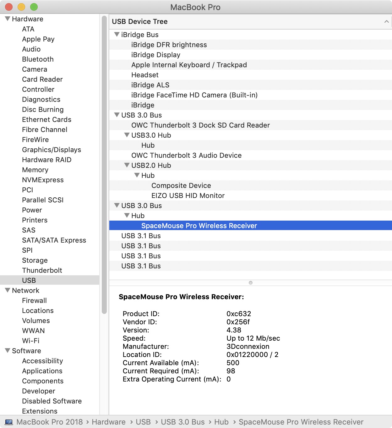

How does one proceed if a driver HAS been installed before? This seems not to be mentioned in the FAQ unfortunately?
I have migrated from my old machine and all relevant drivers and apps have been installed coming from that machine.
I also have tried to reinstall the latest driver version again.
No such pop up menus have popped up
The driver is installed but no hardware is recognized - the hardware is shown as connected in the system too but not recognized by the driver.

I could fix the issue that the Spacemouse is not recognized at all by uninstalling the existing driver and reinstalling the driver.
The issue as described above though that the Wireless Spacemouse is not recognized after each reboot is NOT SOLVED.

Hi menos,
the issue you encounter is a problem with the USB ports. We have reports that this might happen on Windows machines as well with any of the devices. And we see this happen on our lab machine as well with other USB devices than our 3D mouse or CadMouse (or Universal Receiver). It is not 3Dconnexion specific and at this time we still have to investigate what the reason could be. (Our internal bug number for this issue is MAC-48).
