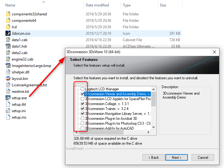

Why wasting so much time digging this problem in a hard way? Let me show you how to solve this in an easy way:
1, Download 7-zip file archiver software and install it.
2, Right click 3DxWare64_v10-5-15_r2944.exe file and 7-Zip>Extract Here, and you'll see a 3DxWare64.exe file, right click on 3DxWare64.exe and 7-Zip>Extract to "3DxWare64\", then go to the 3DxWare64 folder, right click setup.exe and choose 'Run as administrator' to start the installation process.

Because this wouldn't solve the problem you have. You would only workaround it and next time there is an update for the driver you have again problems.luping wrote: ↑Thu May 16, 2019 7:25 am Why wasting so much time digging this problem in a hard way? Let me show you how to solve this in an easy way:
In addition the process described by luping would only install the driver itself and no plugin/addin.

UtaSH wrote: ↑Mon May 27, 2019 2:25 amBecause this wouldn't solve the problem you have. You would only workaround it and next time there is an update for the driver you have again problems.luping wrote: ↑Thu May 16, 2019 7:25 am Why wasting so much time digging this problem in a hard way? Let me show you how to solve this in an easy way:
No, what you stated is not true, check out the screenshot I added in this reply, people with 3Dconnexion device(s) can choose to install the 3DxWare driver and plug-ins/add-ins the way I described before. I managed to install the 3DxWare 10.5.15 and selected plug-ins/add-ins this way. This is an option for me, I don't use the auto update mechanism to check for 3DxWare driver update, I place an very strict anti-big brother firewall policy to prevent outgoing Internet traffic without my approval. Stasi (Ministerium für Staatssicherheit) is not far away.In addition the process described by luping would only install the driver itself and no plugin/addin.
