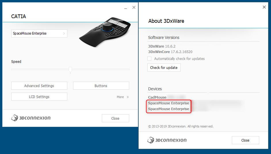

After updating to 3DxWare version 10.6.2 x64, the 3DxService.exe process crash problem is gone. However only one LCD panel of the two SpaceMouse Enterprise displays contents, though all keys of the two devices work as normal.
