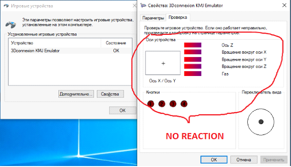

1) Firstly, according to"Product Specification SpaceMouse® Module USB", device should work as a standard USB-joystick.
And actually, device is displaying as standard game joystick, but when I am trying test or calibration buttons and axises of device, there is no any reaction in window of properties. (attachment1)
So why device is displaying, but doesn't work as a standard game joystick?

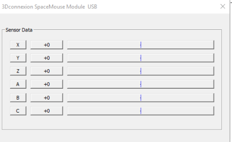

2)Secondly, if it doesn't work as a standard game joystick, we need valid SDK (with samples and documentation) for integrating joystick in our soft.
In described above, downloaded folder, there is two sample project.
Although they are building successfully, no one of they is working.
For example, sample software usb doesn't react on any button or movement of joystick ((attachment2)
Is there any other valid example with SDK?

But anyway, I've downloaded and installed both of them. (pic1)
1) "SpaceMouse Pro" still is detected as a game joistick, but didn't work as a a game joystick. Is it OK?

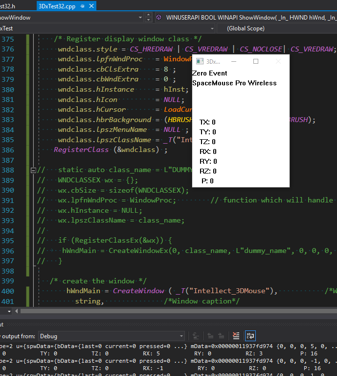

Yes, after installing drivers and SDK. There is a folder - "3DxWareSDK" with couple of demos. (pic2)
For example, 3DxTest solution. But it's also implemented with using HWND objects.
And the HWND object don't get messages about joystick's state if window is not active. (pic3)
It's not appropriate for us, because for our soft we want just get information about joystick movements and buttons without creating window and moreover, without keeping it active.
Don't you have some implementation of SDK without any relating to HWND object?
And if you don't have, at least could you please tell me how can I get around the problem of necessity to be active for HWND object to get messages? For example, can I just create empty window and receive messages not depending which window or process active now?
I googled it a lot, but didn't find anything.
Thank you.

Re: SpaceMousePRO SDK
Hi Ismail,
There is an API function that will grab the device so your application does not need to have focus.
While your application is running, all device events will go to it.
Jim

And I suppose, the most important DLL's is these ones: (pic2)
Can I just pull out some important DLL's which are necessary for work of SDK's function, and use SDK directly without any additional process such as 3DxService.exe?
