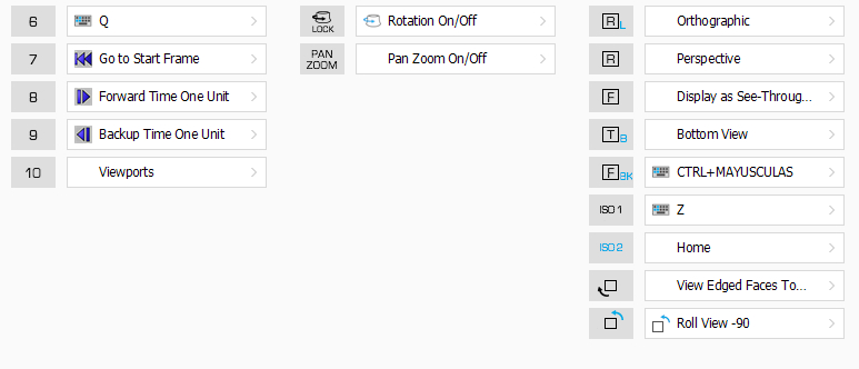

Here is an example of some buttons customized:
As you can see, I could set actions on buttons 7 to 9 to move around frames selecting it directly within the 3DS Max category. I have also assigned some other settings which can be seen at the right like going to perspective, orthographic, etc...

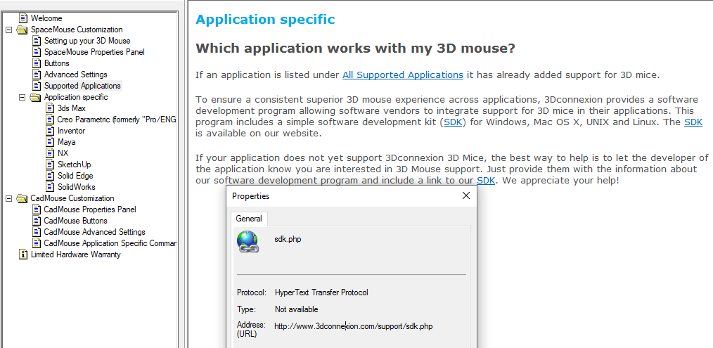

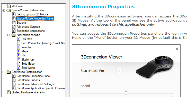

Have you noticed that the help documentation in 3DxWare is never updated to reflect the latest product lineup? No SpaceMouse Enterprise, no SpaceMouse Compact, no CadMouse Wireless pictures displayed in the help documentation, SpaceMouse Enterprise is released back to year 2016, it means that 3Dconnexion people didn't update the documentation for the past 3 years. The discontinued SpacePilot Pro, SpaceNavigtor, SpaceNavigator for NoteBoooks are still in the product lineup picture. The 3DxWare 3Dconnexion Home application screenshot in the help documentation is not updated to reflect the latest version of 3DxWare. The discontinued 3Dconnexion Viewer application screenshot is still there in the documentation. The link to SDK is dead or broken.
It indicates a lot of problems. 3Dconnexion is no longer a Logitech subsidiary, it becomes an independent hardware company again with constrained resource.
