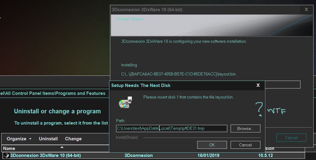

I was just checking my installation, the old drivers v10.5.12 were partially uninstalled
Running the Uninstalled on the driver produces another stupid error, the setup programs looking for a layout.bin file, wtf?
I'll try to get 10.5.12 installed again but yeah this sucks
