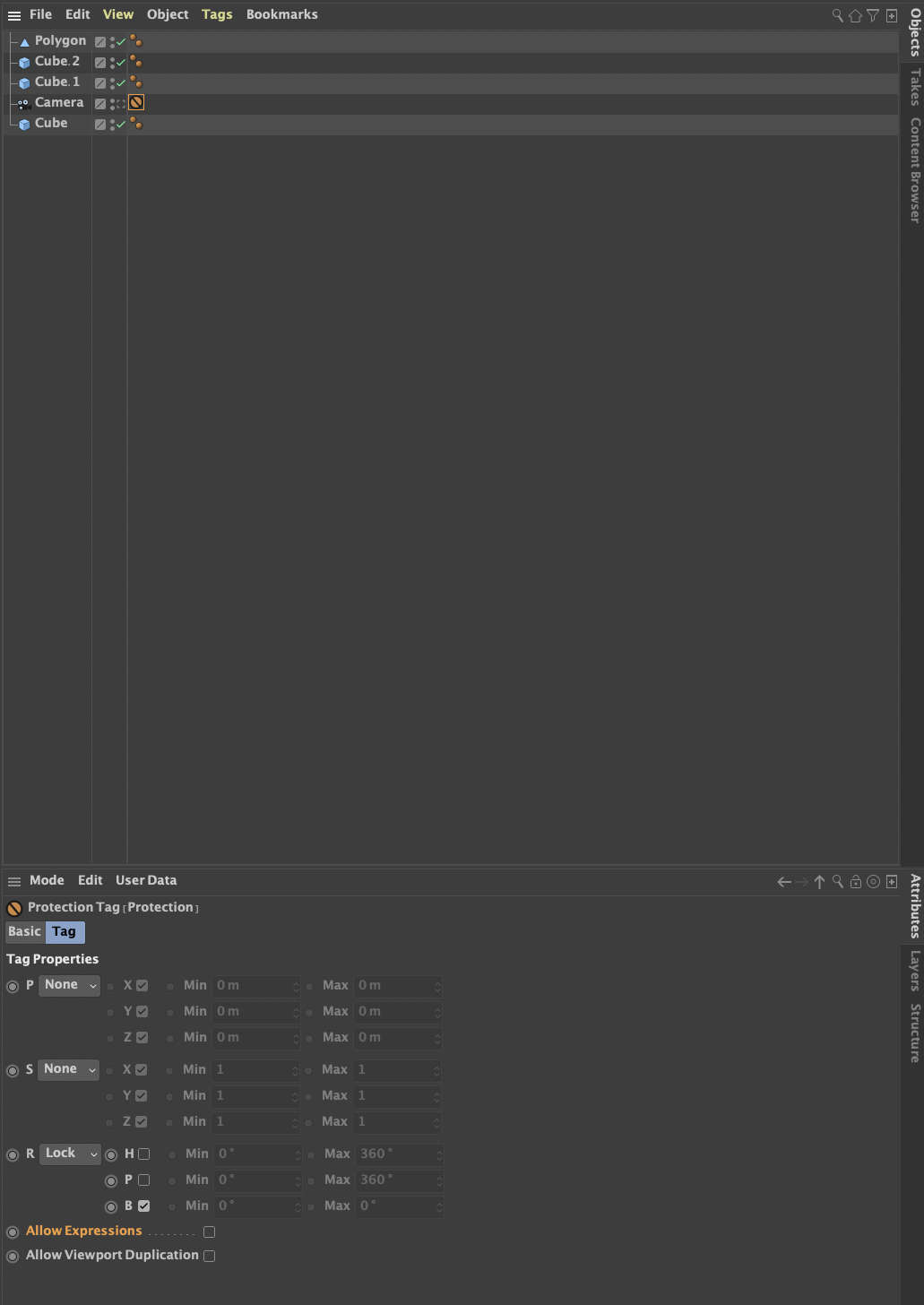

You can get horizon lock by applying protection tag to an camera and than use that for general viewport navigation.
Screenshot 2019-11-1.jpg (70.53 KiB) Viewed 15454 times

Interesting.
Will try that cameratrick.
