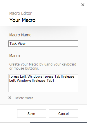

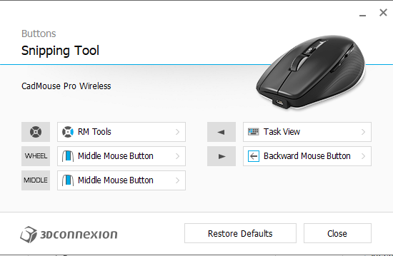

More specifically, I want the "Forward Mouse Button" to perform the WIN-TAB macro (Task View) by default no matter what application I'm using, ideally without haviong to set it manually within the GUI for every single application as shown below.
A previous thread advised changing the <Devices> portion of the Global.xml Cfg file to match the <Devices> portion of an .xml file for an application that had already been modified using the GUI. The problem I'm having with this is that none of the applicaiton specific .xml files seem to be updating when I change a button function using the GUI. The function still works when I change it using the GUI, even though the .xml files are not being overwritten for that specific application. Am I missunderstanding how this is supposed to work?
