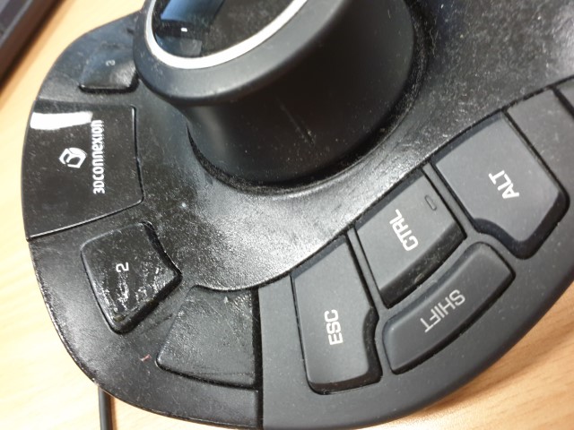

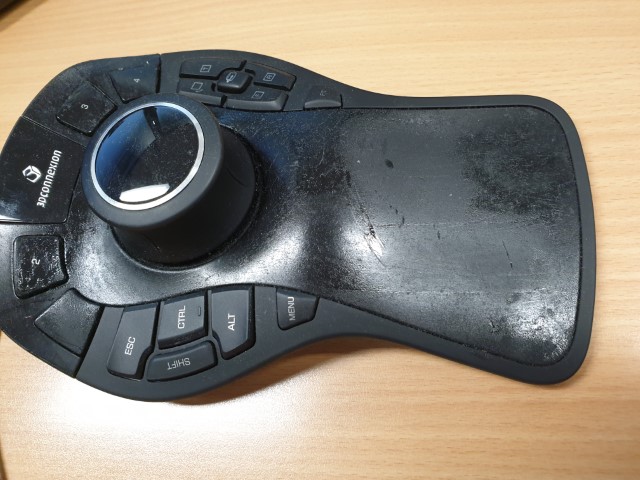

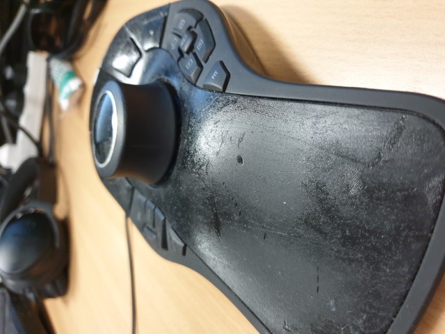

In our office we have several spacemouse's (4x) and a single Spacemouse Pro.
At least one of the Spacemouse Knobs has started to go sticky, but the biggest concern is the Spacemouse Pro!
The knob is OK, but the rest of it!!!
This device is several years old, but has had minimal use and non in the last 18 months, (The original operator left the company, and it's been sitting on the unused desk)
20200421_154858 (Small).jpg (115.34 KiB) Viewed 163575 times
20200421_154903 (Small).jpg (102.21 KiB) Viewed 163575 times
20200421_154853 (Small).jpg (112.78 KiB) Viewed 163575 times
For the price paid for these, the quality is terrible!
It there anything that can be done?

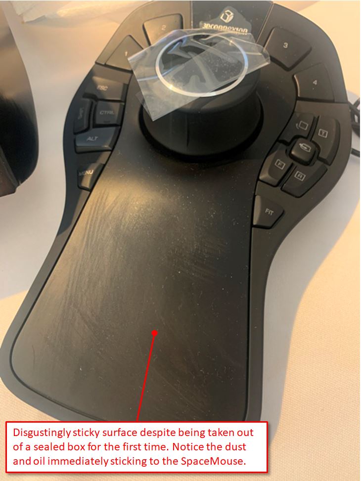

I bought a brand new, sealed-in-box, 3D SpaceMouse Pro. Upon breaking the seal (and to my horror), I realized the 3D SpaceMouse Pro was rubber-coated and it was disgustingly sticky!
Sticky, sticky, sticky!!!
I was horrified!!
The excitement that was building up in me turned into anger, especially considering how expensive this device is. What kind of Product Designer would even think of spraying a tacky and rubbery coating on their mouse!? Trying to clean the sticky surface with a damp cloth just makes it worse, as the lint and fibers from the cloth just sticks to the SpaceMouse!!

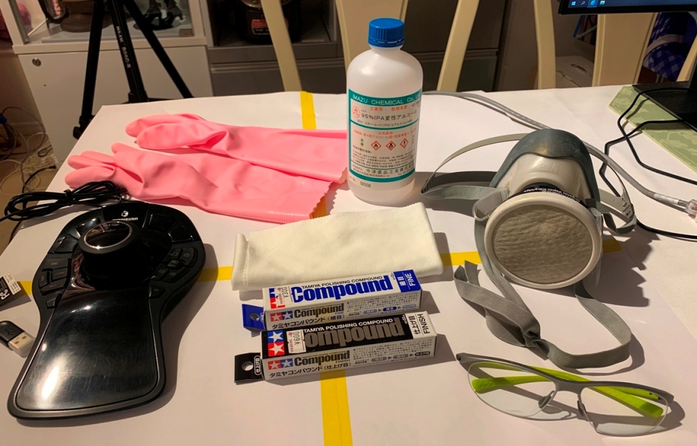

THIS IS MY TUTORIAL TO "SAVE" YOUR 3D SPACEMOUSE PRO!!
Shopping Guide:
Tamiya Fine Compound
Tamiya Finishing Compound
95% Isopropyl Alcohol
Disposable Microfiber Cloth
Polishing Cloth
Q-Tips
Chemical Respirator
Apron
Safety Gloves
Safety Glasses
2 Towels
CAUTION:
Isopropyl Alcohol is dangerous to your skin and eyes. The vapors from this chemical is also dangerous. Wear safety glasses to protect your eyes against chemical splashing. Put on an apron to protect your clothes. Wear a respirator to protect against dangerous vapors. Wear safety gloves. Work in a well ventilated space. Be careful not to spill the Isopropyl Alcohol! If your skin contacts the Isopropyl Alcohol, wash it with warm water and soap.
1) Lay 2 layers of towels over your work area in case of accidental spillage of chemicals.
2) Put on your safety equipment.
3) Dampen the microfiber cloth with Isopropyl Alcohol and begin wiping the rubber-coated areas of the SpaceMouse. When your cloth gets dry, dampen it again with Isopropyl Alcohol and keep wiping. As you wipe, notice the cloth begins to darken as the rubber coating starts coming off. This process of removing the rubber coating from the SpaceMouse takes time, so be patient and keep rubbing until you get a nice smooth surface.
4) Dampen the head of a Q-Tip and stick it under the knob of the SpaceMouse to wipe the surface below it. The Q-Tip will turn black as the rubber coating begins to come off. When the Q-Tip gets blackened, throw it away and use a new one. Repeat this process until it's nice and clean.
5) When you have removed the rubber coating from the entire SpaceMouse to your satisfaction, apply a little Tamiya Fine Compound to the polishing cloth and begin polishing your SpaceMouse until it starts to shine.
6) After you have thoroughly polished the SpaceMouse, apply the Tamiya Finishing Compound to the polishing cloth and polish the surface of the SpaceMouse until you get a mirror finish. Keep polishing until you are satisfied with the result.
That's it!
