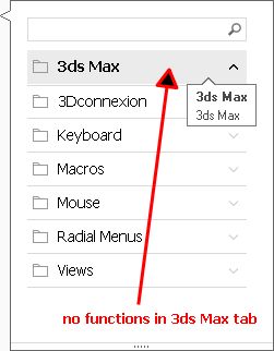

Go to customize the buttons for use with MAX2014... empty 3dsMax tab... no functions.
Go to customize the buttons for use with MAX2020... all functions available.
Any idea how to get the 3dsMax functions available again when using MAX2014?

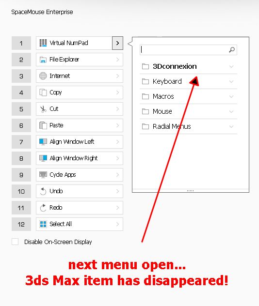

I should note that after it initially worked in MAX2020... the next visit to the button config menu, the 3dsMax tab was gone.
Driver version 10.6.4
Thanks!

Then rebooted and installed the 10.6.4 driver. Got weird flashing of the object when orbiting via the knob. Went to config buttons and all the 3dsMax functions were gone from the list.
Uninstalled drivers and deleted the 3DConnexion folder and rebooted. Reverted back to the 10.6.0 driver and all is well.
