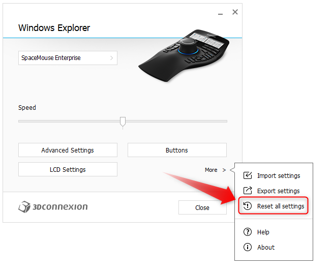

Try reset all settings.

Thanks, i did, but the issue remains :(
