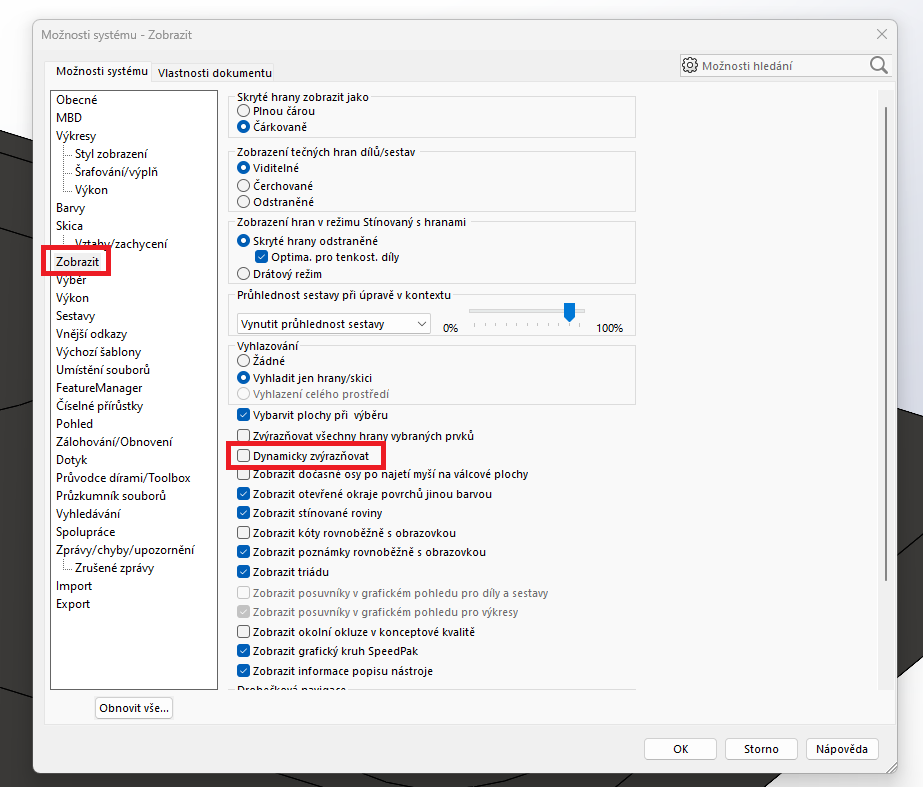

Hi gcaldwell1,
did you check if you have "Dynamic Highlighting" enabled. Try if disabling it works better.
If that is the case you can use the option in the Advanced Settings of the driver to have the plugin handle it.

Hi,
I solved the lagging issue with regular mouse + 3D mouse moving together.
Try to turn off in the Settings on the tab "Display" the "Dynamic Highlight".
I am not sure with the exact EN-translation in SolidWorks.
This helped me, but unfortunately you wont see the pre-selected highlighted elements, before you click on them.
