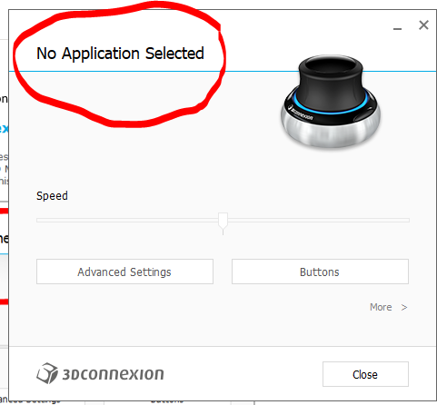

hello, are there any solutions? having the same problem for cad mouse wired. under device manage 3Dconnexion KMJ Emulator is listed.
Capture no app selected.PNG (34.9 KiB) Viewed 9066 times
UtaSH
Posts: 3754
Location: Munich, Germany
Re: 3dconnexion properties no application selected
Post by UtaSH »
Hello bozersky,
your device is not recognized by the operating system. I recommend to contact our Technical Support Team.
