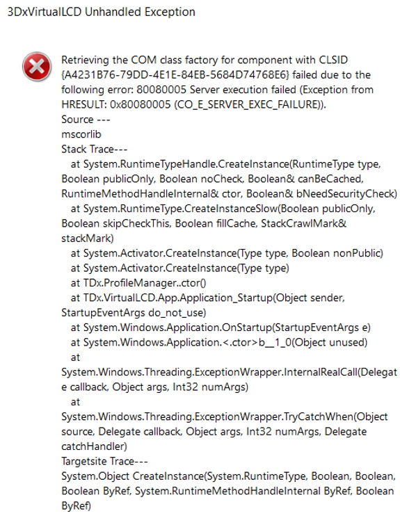

Ever since updating to the latest driver, I get a "3DxVirtualLCD Unhandled Exception" error almost every time the driver starts. I've tried stopping the driver, deleting the 3DxVirtualLCD directory in "C:\Users\<user>\AppData\Local\3Dconnexion", and restarting the driver. Sometimes this works temporarily, but the problem will always come back within a day or two. Based on the forum history, this exact same issue has persisted with other users for at least 3 years now. When will there be a fix?
3DxVirtualLCD Error.jpg (215.01 KiB) Viewed 10894 times

Hello takedownca,
I apologize for the trouble you encounter. We are tracking this issue with our internal bug number TS-79. Currently we are not able to reproduce the issue on one of our machines which makes is quite difficult to find out where the problem is. I will post here once we know more.

Hi takedownca,
takedownca wrote: ↑Thu Feb 20, 2020 11:07 am I have Trend Micro
Apparently, so do everyone else affected.
Could you please check why Trend Micro is blocking access to the file "3dxprofileserver.exe"? We cannot explain why this is happening but it may be related to a recent update to Trend Micro.
Also, if there is some sort of logging explaining which files from 3Dconnexion are being blocked, we would appreciate if you could post the information here. It would be interesting to see why Trend Micro is blocking access to "3dxprofileserver.exe".

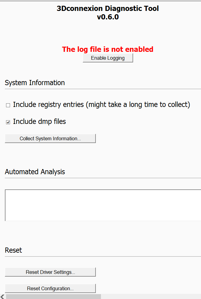

The diagnostic tool doesn't seem to be reporting anything. I can't enable logging either. It just disables again.
Capture 2020-02-24 3.png (15.39 KiB) Viewed 10727 times
jwick
Posts: 3456
Location: USA
Re: 3DxVirtualLCD Unhandled Exception
Post by jwick »
It doesn't do anything until you tell it to. Should it? That's a good question.
At this point it is expected to be run when you are on the phone with tech support. They would guide you through it.
Perhaps I should put some minimum instructions at the top.
If you can't Enable Logging through tool, use the 3Dx systray icon (right click).
Does it do anything when you click on "Collect System Information"?
When it is done, it should open the dir with a zip file that contains the collected system information.
Could you dropbox/WE/OneDriver/whatever that to me?
It might not warn. I'm looking for a specific Trend Micro product. You might have a different one. Probably the problem is the same though with the newer packaging.

Hi takedownca,
As far as we can tell, this issue is isolated to systems with Trend Micro installed. We do not know why Trend Micro is blocking access to the executable "3DxProfileServer.exe", an out-of-proc COM server used by several other driver components such as 3DxVirtualLCD.
Adding an exception for "3DxProfileServer.exe" in Trend Micro ought to allow you to run whatever driver version you need.
Other than that, installing a different driver version may work around the block, yes, but this is probably a roll of the dice.
