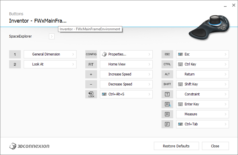

I have recently started working from home part time. I connect to my work desktop through a Remote Connection and to make my SpaceExplorer (3DConnexion) work I run it through a USB Redirector program.
When I am at home, the only Environment available to map the 3D Mouse buttons is "FWxMainFrameEnvironment". That's fine, I assume it's because of the setup. Unfortunately, when I come back to the work computer this doesn't change. It no longer cycles through Sketch / Part / Assembly etc. It is stuck on "FWxMainFrameEnvironment". I have tried to restart the driver; there is no update to the drivers as this is now an unsupported device.

the navigation for Inventor is native to the application, but the Add-In is necessary for the buttons to function properly. Can you please check if the plugin is installed and loaded?
The Add-In can be found by opening a file and selecting the Add-Ins button found on the Environments tab in the ribbon. You should see an entry "3DxInventor" and the load behavior has to be set to "Automatic/Loaded".
