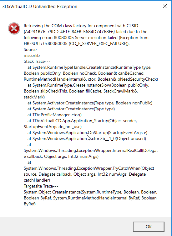

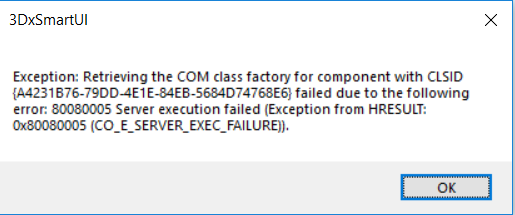

When trying to bring up the menu on the spacemouse pro, i get these 2 errors
any ideas?

Hi spotts,
this is very likely a problem with your antivirus software. Are you using Trendmicro. In anyway you should create an exception for the program "C:\Program Files\3Dconnexion\3DxWare\3DxWinCore\3DxProfileServer.exe".

UtaSH wrote: ↑Mon Jun 08, 2020 7:29 am Hi spotts,
Thank you, doing this fixed my problem.
