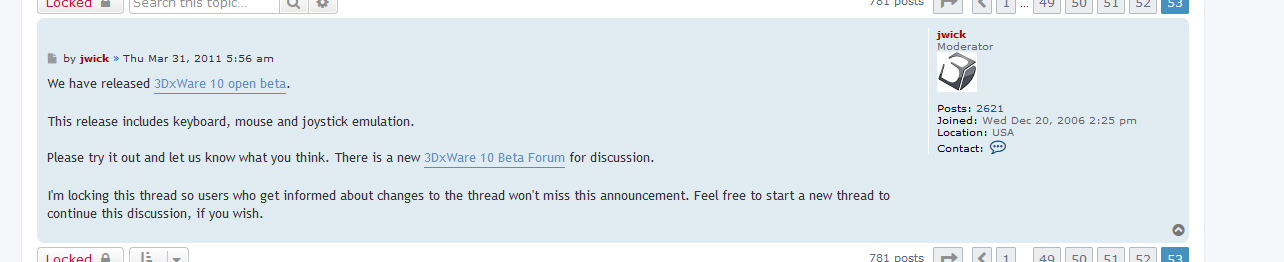

So, i have one at home now and would really like to use the navigation tool in eagle ECAD and perhaps this or that app. Some years ago you posted in the forums what i'm referencing in the attached pic. I was wondering what the issue is here?

Hello dumbweighter (that name does sound familiar),
I'm happy to help. People who build things just want people to use them.
That Beta program was for the driver that is now shipping.
The only substantial change is that the GUI does not support much of the functionality the beta GUI supported.
The underlying XML mechanisms still work, AFAIK -- they don't get much testing so things may break.
You have to make the XML file changes that the GUI used to make. Or get one of us to create the XML changes for you.
The process starts with deciding what needs to be sent to the app.
The best mechanism is a proper 3D mouse interface, but that's beyond the capabilities of most.
Non-games generally don't support a joystick.
Most CAD apps support some sort of mouse interface.
It is possible the keyboard is supported. There's no standard there.
