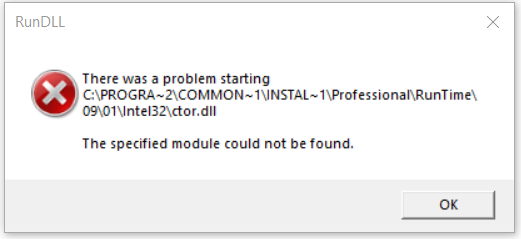

I am having this issue as well. I cannot uninstall my 10.6 version. I added the error message. Any suggestions are welcomed.
UtaSH
Posts: 3754
Location: Munich, Germany
Re: Problem with windows installer package - installation failed
Post by UtaSH »
Hi spidermanvos,
do you still have the installer of that old version that was/is installed on your machine? I recommend that you proceed as follows:
  1. Uninstall as far as possible any 3Dconnexion software.
  2. Reboot your machine.
  3. Install the older (previously installed) version of the driver.
  4. In case this was successful - reboot the machine.
  5. uninstall the driver.
  6. Reboot the machine.
  7. Install the latest version.
Let us know if this works. In case you don't have the installer fo the older version or you don't know which version had been installed before or if you still run into problems: please contact our Technical Support Team.
