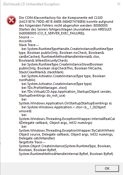

This error occures on the PC - how can this be resolved?
Thx in advance.

Using Trend Micro perhaps?
Others have reported similar issues when using Trend Micro (see here and here).

Yes we are using Trend Micro ;) Thx for advice.

KOPFGmbH wrote: Wed Sep 16, 2020 12:21 am Yes we are using Trend Micro ;) Thx for advice.
If you ever come across with the cause of this issue (Trend Micro blocking a driver component), we would very much appreciate if you could share the information.
We don't know why Trend Micro is blocking the driver. It makes no sense.
