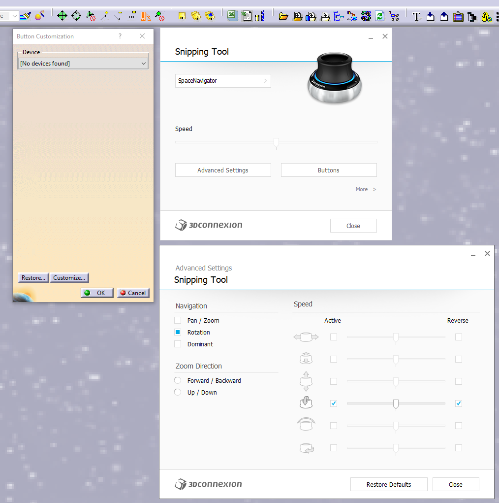

Good morning. I just recently was upgraded to an HP Z6 Workstation with Windows 10 64bit OS. I run CATIA V5R26, Rhino6, NX11, and Spinfire Ultimate.
The Space Navigator works great in all of these apps except for CATIA...My IT personal and I have read through extensive forum threads and tried everything from uninstalling the drivers and re-installing the latest drivers. We rolled back to the previous driver, an tried bypassing the firewall.
All to no avail. This is a mystery to me how this could work flawlessly for years on Windows 7 and now nothing.
Please note that the Space Navigator has some kind of communication with CATIA because I can manipulate the axis lock outs and sensitivity, but there is absolutely no 3D space manipulation of data response at all.

the screenshot is odd. The device is recognized by the driver, but not by Catia. :? Are you starting the driver and Catia with the same user privileges? (See here.)
Additionally please verify if removing the settings for Catia would clear this. Proceed as follows:
  1. Stop any running Catia.
  2. Navigate in the file explorer to the folder C:\Users\<your_user_name>\AppData\Roaming\DassaultSystemes\.
  3. Copy the folder CATSettings to another location and then remove it.
  4. Restart Catia. - Still the same situation?

The Space Navigator works in all applications but only works partially in CATIA:
1) NO 3D manipulation response at all.
2) Space Navigator button menus respond to CATIA.
3) 3Dx Device menu responds to rotations/sensitivity.
4) 3Dx Device menu states no device found.
Trouble shooting steps tried:
1) bypass firewall
2) exception for CNEXT.exe added
3) uninstalled/ reinstalled current drivers
4) uninstalled/ reinstalled 10.5.3 drivers
5) started/stopped 3Dconnexion drivers
6) backed up and cleared 3Dconnexion folders with REGEDIT.exe
