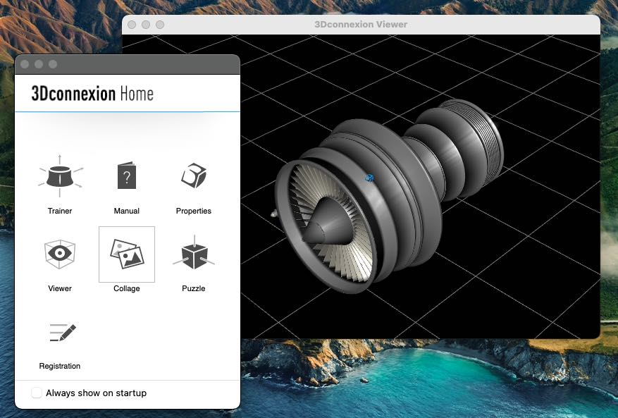

I have the "3Dconnextion Home software" window in front of me and click on Viewer to bring up the model of the jet-engine, but it either does not move at all, or it takes a very long time of holding the joystick in one direction to get it moving.

Also the Jet-engine demo as shown in the picture moves in steps / moves choppy. The SpaceMouse is unusable in this state, I have rebooted several times, tried another USB port, tried another USB-A-C adapter, tried it in Google Earth and Fusion 360 and the Puzzle Demo but nothing works as it did before. The input lag is still several seconds.
