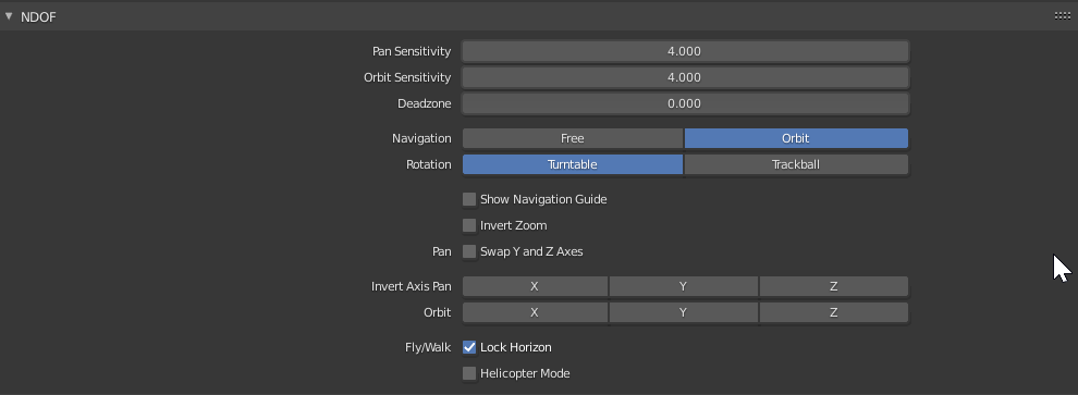

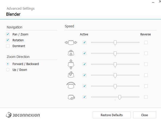

Difficult to explain but here I go.
  • Checked the blender settings, can swap the Y&Z. Can't swap the X&Y and if I'm not mistaken, these are the one I want.
Checked a lot of stuff, don't know which one rules over the other.

Their Y&Z swap probably refers to the "zoom direction". That is whether you go into the screen by pushing up/down toward the desktop vs pushing in/out toward the monitor. It's sometimes a personal preference. Our GUI offers a similar option. We discourage its use, especially in a 3D scene application like Blender with a horizon. You should think of moving yourself around in the depicted 3D world.
Your Base.xml looks fine. What happens with it?
If you have a user Blender.xml file in %appdata%\3dconnexion\3dxware\cfg, then you will have to put those Base.xml entries in there instead. The %appdata% file will be override the defaults defined in Base.xml.
