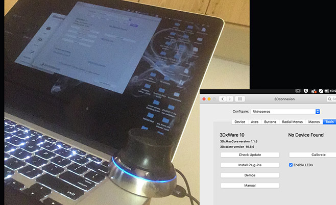

Hi thanks. I'm in contact with support but they haven't given me an idea what to do.
attached is a picture of the device connected and yet not recognised, that is with 10.6.6.
the device behave as if it was some kind of a sluggish mouse, [moving the cursor slowly across the screen.]
All I can tell is that it was working normal [on 10.6.1 ] up to the point of attempting to upgrade the driver.
So if someone has 10.6.1 please, so I can try to get my device back to the point where it was all good.

Akash wrote: ↑Wed Dec 09, 2020 4:21 pm the device behave as if it was some kind of a sluggish mouse, [moving the cursor slowly across the screen.]
Looks like the kernel extension isn't loading. There is a security feature in macOS that forces users to "allow" kernel extensions within a 30min time frame.
Do you see a warning panel when the driver starts in the "3Dconnexion Home" window? This should be displayed after signing in following a reboot.
