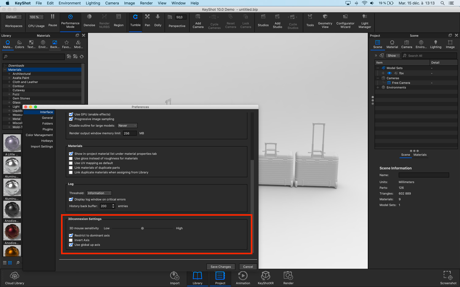

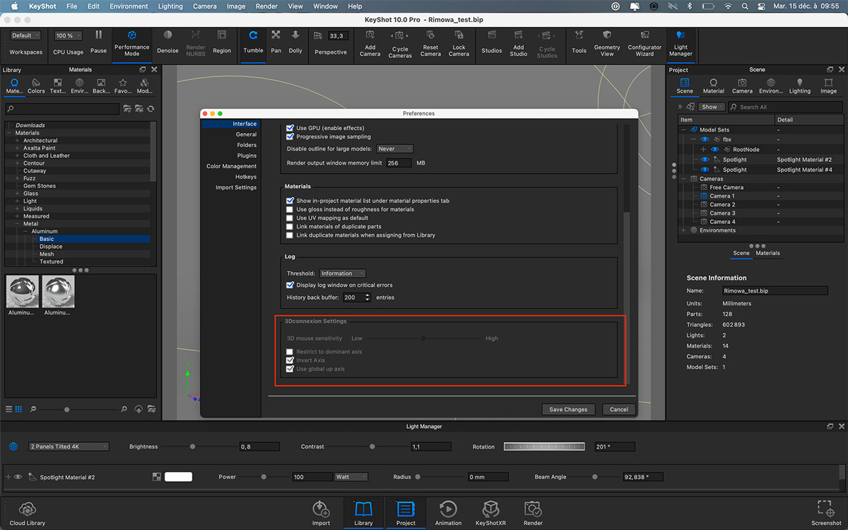

* My spacemouse isn’t working neither in Keyshot 9 or 10 in my BigSur configuration. I have seen a testimony from a user on Mac OS Catalina on the Keyshot forum, saying that is spacemouse wasn’t working with Keyshot 9 but was now working with Keyshot 10. But for me in my Keyshot 10, with BigSur it is not working. The 2 buttons configured from my spacemouse wireless can be well launched but the spacemouse itself isn’t moving anything 😭. Beside this, my wireless compact mouse in Keyshot 10 is working perfectly...

In the preference panel of Keyshot, the 3dconnexion setting is all greyed... (see screenshot attached). Now that I start loving my spacemouse wireless with C4D, and that I know that the spacemouse was apparently working in keyshot 10 with Mac OS Catalina (not tested by me), it is frustrating to see it is finally not working with my configuration...

simon.djin wrote: ↑Tue Dec 15, 2020 2:23 am In the preference panel of Keyshot, the 3dconnexion setting is all greyed... (see screenshot attached).
While looking this up with my colleagues, the following came up. At this point, we suggest to get in touch with Luxion and confirm the SpaceMouse support status for KeyShot on macOS 11. The issue you're observing may not necessarily be related to the beta driver.
We're in touch with several software vendors and we can also work with Luxion to resolve any issues with SpaceMouse support.

I also have a Mac OS Catalina 10.15.7 installation on my external SSD, so I did a test with Keyshot 10 demo on this installation and after installing 3DxWare 10.6.6, the Spacemouse works in Keyshot 10. This is just a test / emergency installation on this external SSD. All the axes are working and the 3Dconnexion settings in the Keyshot preferences panel aren't greyed anymore (see screenshot attached).
But this time the 2 buttons aren't working at all, to execute simple 2D clicks, a system action or even launch a radial menu, none of those configurations for the buttons work with the universal receiver or even wired. And the 2 buttons of course work in the other applications.
The 2 buttons were working correctly in Keyshot 10 with BigSur but not the axes and moves as I told you. I would prefer to have my spacemouse axes and moves working in Keyshot 10 and no buttons rather than the contrary. So do you think the problem comes from your side or from Luxion now that we know that something apparently happened with BigSur?
