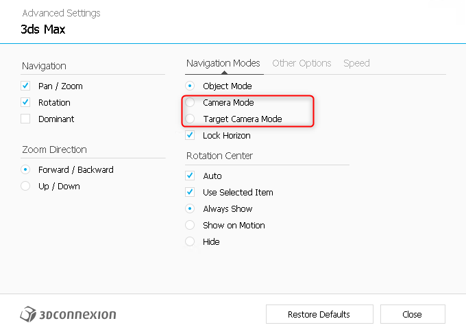

Hi Coastavis, I'm trying to understand the problem a little better from my side. Over the past several months I've been trying to reproduce various camera issues in 3DsMax with no luck. Can you tell me what 3DsMax version you're using? Also, what 3DxWare version do you have?
Does the viewport ever become so unresponsive that 3DsMax crashes? If so then we may be able to get a crash dump to see what's happening.
When you mention trying to move a target and free camera I assume you are creating these cameras in 3DsMax. You aren't referring the camera and target camera modes in our driver right? (see example below)
Does the problem happen when only in a 3D viewport, or does it also occur when in a 2D viewport as well? If you can tell me what steps you're taking then I may be able to reproduce the issue and verify the problem.
