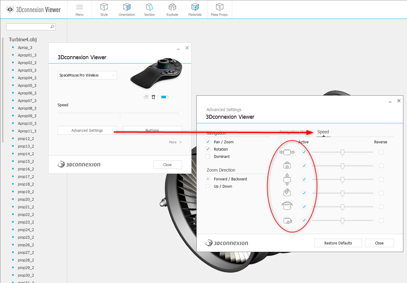

Open the 3Dconnexion Viewer application, while the application window is active, hit the MENU button on your SpaceMouse Pro Wireless and call out the configuration panel, click the Advanced Settings, and then switch to Speed tab, check and see if all the axes are ticked and active. See the below screenshot.
SMPW menu.png (151 KiB) Viewed 2620 times
