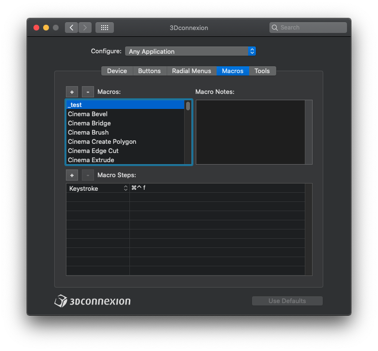

gobluejd wrote: ↑Tue Jan 26, 2021 8:52 am However when I change to Keystroke, it will only allow one character. How to I set up in Keystroke with multiple keys?
You can simply assign a keystroke directly to a button or you can edit a macro like shown below:

When I hit the command key, with it set to keystroke, it does not do anything. Only regular keys will show. Am I not doing something correct? When I create a new Macro, change dropdown to Keystroke and hit the COMMAND KEY, nothing happens. If I hit say the a, it will display a.

gobluejd wrote: ↑Tue Jan 26, 2021 9:28 am and hit the COMMAND KEY, nothing happens. If I hit say the a, it will display a.
And if you hold down the cmd key whilst pressing the "a" key, say?
Basically, press the modifier key down, press and release the printable key ("a", "b", etc) and then release the modifier.

Sorry. I was just trying to hit it individually. When I do the actual sequence it works. Thank you!!!
