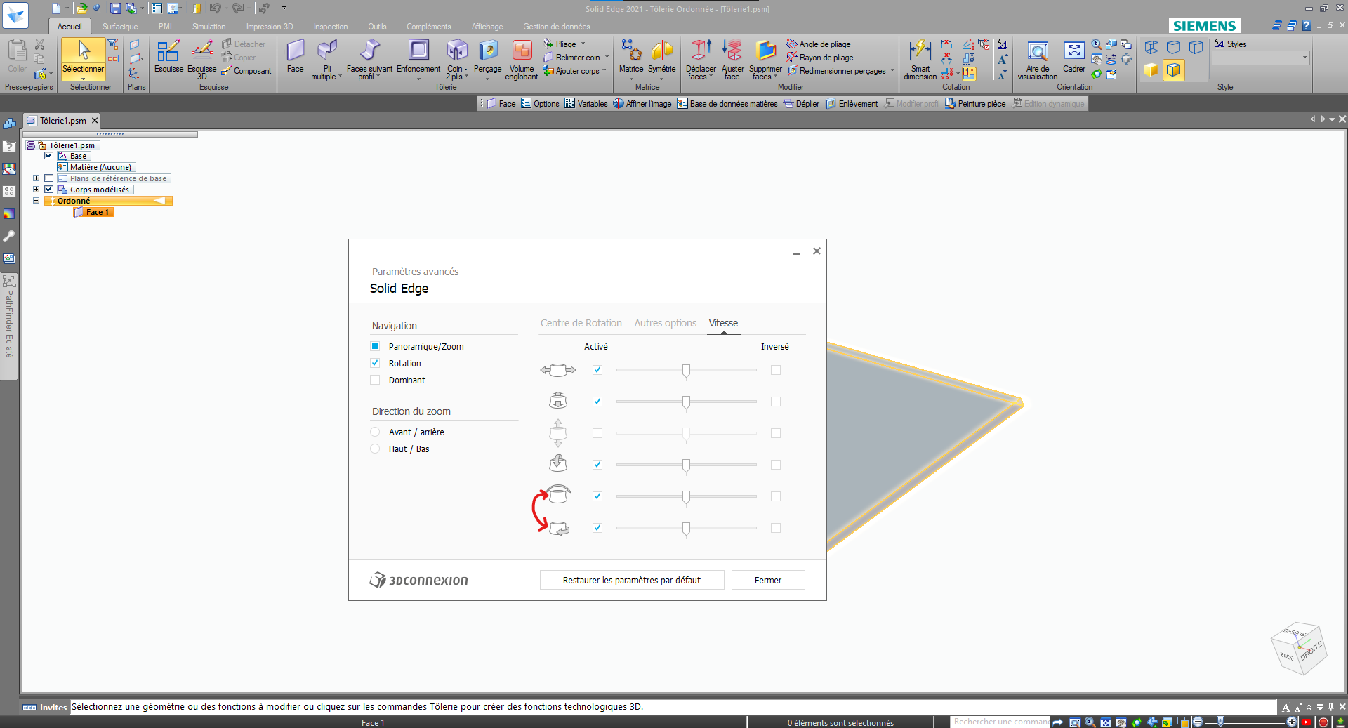

I there. I have a problem with my new Space Mouse Compact. I've a Space mouse Enterprise at work and i just bought a new Compact form my personnal use. The problem ir's that a cannot put the same rotation that i use at work (like i'am use to) at home. Those to are inverted on my Enterprise. Does some body know how to change it?
Capture d’écran 2021-02-08 204014.png (204.64 KiB) Viewed 1188 times

How did you make the changes on your work machine? The same changes don't work at home?
The changes will be saved in an application-specific XML file in the %appdata%\3Dconnexion\3DxWare\Cfg dir. (SolidEdge.xml)
The changes made by the GUI are device-dependent but the syntax is identical. Those changes can be copied from the SpaceMouse Enterprise Device section to the SpaceMouse Compact Device section (look for Axis...). If you are not using the same machine at home, take the SpaceMouse Compact into work, make and test the changes and then take the file home.
I can help you if you need more details.
