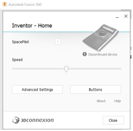

Spacepilot getting confused between Fusion 360 and Inventor
Hi.
I have an old space pilot and after managing to get the 10.4.10 driver working in Fusion 360 (see earlier post) I came across another problem. Initially it works fine but then it suddenly thinks that is it using Inventor (see picture). This happens even when i click on the application. I don't have Inventor on my machine so I have no need for the configuration. Is there a way of stopping it going over to Inventor every-time?
Thanks
J
Thanks
J

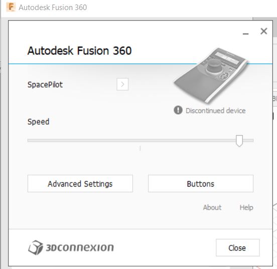

Re: Spacepilot getting confused between Fusion 360 and Inventor
Hi JWICK
That's a bit strange as it does recognise it when I first open the program and use it for a couple of minutes (see picture below) and everything works fine
It then goes back to the Inventor-home config and wont come out unless i restart the driver. When it is in the 'Inventor-home' config it does not work at all. Is there a way of stopping the 'Inventor-home' config and keeping the 'Fusion 360' config
Thanks
J
Thanks
J
Hi
Tried to delete the configuration but it still recognises it as AdCefWebBrowser.exe (AdCefWebBrowser.xml)
The space pilot still says "Inventor -home "
Any other ideas?
Any other ideas?

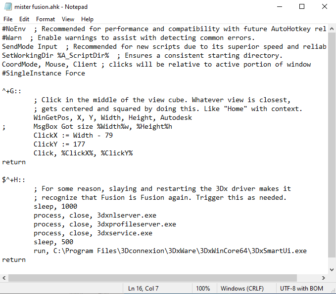

I have a solution for this. It's hacky, but hacky is better than throwing perfectly good hardware in a landfill.
First, while it's confused and thinks you're in Inventor, define a new macro, which pushes a key combination that isn't used for anything else on your machine. In my case, I'm using Ctrl-Shift-H. Then, assign that macro to as many buttons as you'd like, within the Inventor context. I went a little nuts...
(Side note, putting an exclamation mark in the name of your macro is a bad idea -- if you subsequently try to edit the macro, it crashes the program! Still works just fine, you just can't edit it.)
Then, install AutoHotkey and whip up a script that hooks the key combination you just put in the macro. For Ctrl-Shift-H it goes like this:
Now, when you find your Spacepilot a little spaced-out about where it is, oh look! All those "I'm not inventor!" buttons, just smack one! (The sleep 1000 makes the script wait a moment for your finger to spring back up off the button; I had trouble without this.) We slay a few processes (Are all of these really needed?), pause for another blip, then restart the UI which forces the driver to come back up.
Et voila, the next time you click over in the Fusion window, it knows you're in Fusion! (Until you open a new file and it thinks you're in Inventor again, then just smack the conveniently placed button again.)
Nota bene: Don't have the AHK script running while you're defining the macro; it'll trigger and kill the driver you're trying to teach a macro....
Code: Select all
$^+H::
sleep, 1000
process, close, 3dxnlserver.exe
process, close, 3dxprofileserver.exe
process, close, 3dxservice.exe
sleep, 50
run, C:\Program Files\3Dconnexion\3DxWare\3DxWinCore64\3DxSmartUi.exe
return
- Attachments
- scripty script.png (41.41 KiB) Viewed 17026 times
- makethemacro.png (54 KiB) Viewed 17026 times

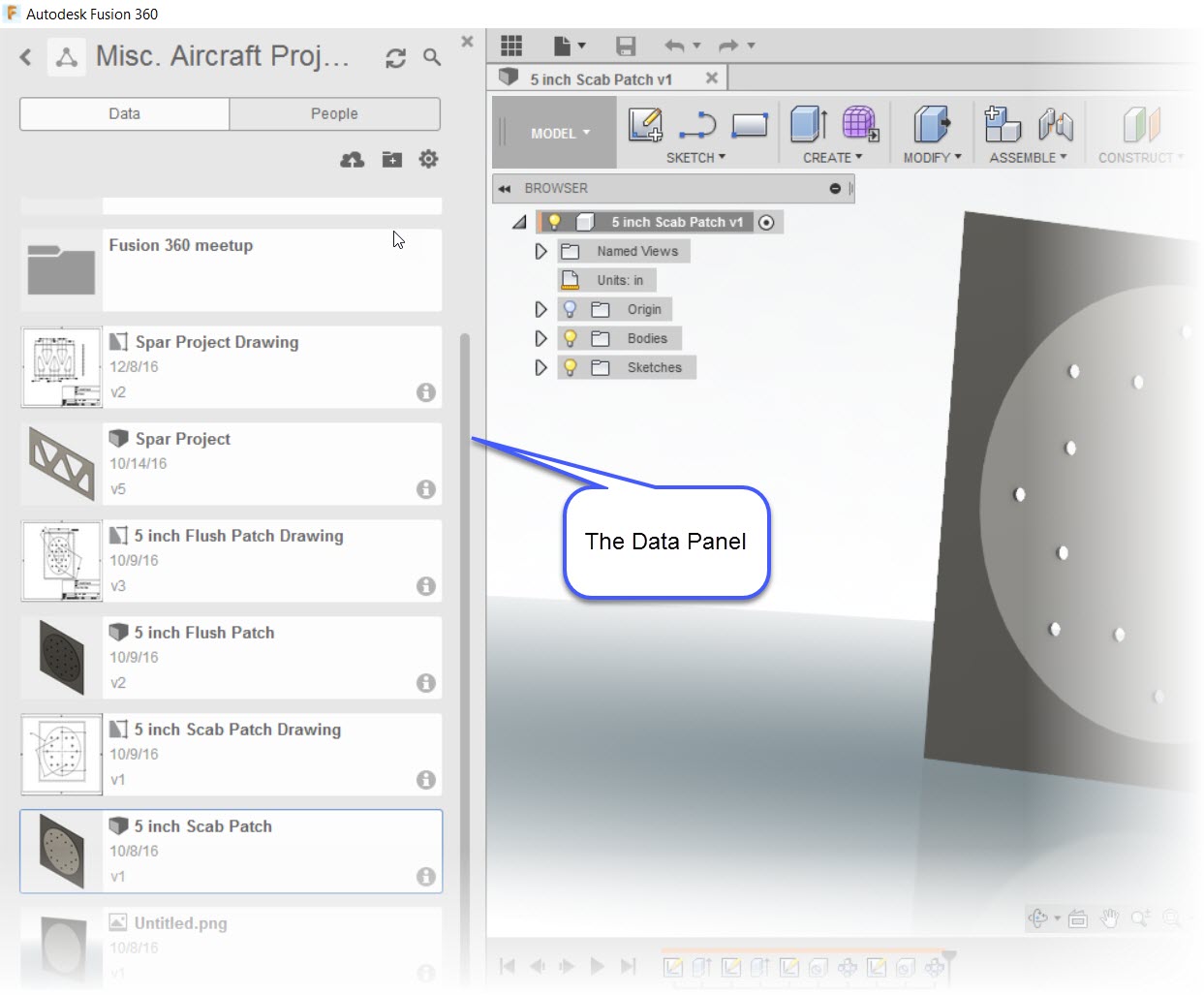

That it does, thankfully.
It seems to flip over to this whenever I use the "data panel" file selector at the left side of the screen. Which is fine; there's no need for a 3d input over there; it's a 2d context with a scroll bar. But then when I click back into the design panel (or whatever they call it, the main design pane) to continue working in 3d, it doesn't flip back to the Fusion 360 context, it stays stuck in Inventor. That's actually the problem, it's not flipping to Inventor in the first place, it's failing to flip back to Fusion.
10.4.3, the last anti-landfill version.
Ooh, that would be perfect! No other apps at the moment, but probably Solidworks soon. A single config all the time sounds ideal; that's what I had with 3.16.3 and it was rock solid. Or at least, being able to manually force and lock the config would be a nice workaround.
I had really stellar results, perfect, everything was exactly the way I wanted it, with 3.16.3, except that it couldn't define the function of the "3d lock" button in the middle of the view pad, and I really wanted to redefine that. (It's mapped to ctrl-shift-G, and triggers the square-the-view macro also seen in my autohotkey script. That's the function that sent me down this whole rabbithole in the first place.)
While I'm here, I might as well ask about another workaround I considered, and which doesn't work: I figured, why not just clone the f360 config into the inventor config, so it doesn't matter which one is loaded? But weirdly, the "view" options don't even appear as things I can apply to buttons when in the "inventor - home" config. And the 3d control doesn't work at all -- it's like my input is being sent to the 2d file selector pane, despite my having clicked back into the 3d design pane. The only way to fix this on the eco-friendly driver is to kill it and let it reincarnate...
- Attachments
- NoViewsMenu.PNG (188.74 KiB) Viewed 17008 times
- ViewsMenu.PNG (100.31 KiB) Viewed 17008 times
- Data Panel.jpg (108.15 KiB) Viewed 17008 times

david_j_calabrese
- Posts: 14
- Joined: Sun Jan 31, 2021 8:50 pm
This is admittedly an annoying issue, and one must remember to click on the "Browser" bar in Fusion 360 to get the SpacePilot to kick into Fusion 360 mode.
Anecdotally, there seem to be a lot of users with SpacePilots still in use today, so another +1 for an Extended Support plan (paid) that involves official driver support for these legacy devices in 10.7.2, etc. I feel like this is money that 3Dconnexion is leaving on the table. And/or releasing an Open Source driver project so folks like those who wrote the integrated Blender 3Dconnexion driver can chip in.
Honestly, I think the appeal is that the SpacePilot is probably the nicest hardware that 3Dconnexion has produced, with an easy-to-read screen and many large, responsive, accessible buttons. I think the only shortcomings are the curved Config and Panel buttons which are tricky to press if used regularly. Also, the units were clearly built to last, because even heavily used devices look brand-new today. The next best thing would be a SpaceMouse Enterprise, although the screen isn't as readable, and price-point is fully half the cost of a ZBrush perpetual license.
A "SpacePilot 2" I think would be an interesting device to develop next, a mid-level entry something like a re-release of the SpacePilot Pro, though with a better, bigger, horizontal screen (could even be B+W) and the 1-6 buttons below the screen horizontally vs the 4+1 "quad" arrangement of the Pro.
