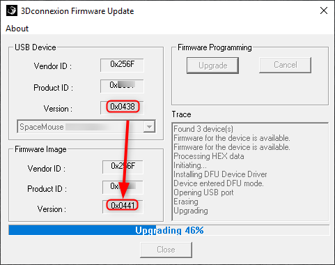

Try to update the firmware:
https://www.3dconnexion.com/technical_s ... r17928.exe
firmware update.png (23.99 KiB) Viewed 1712 times
