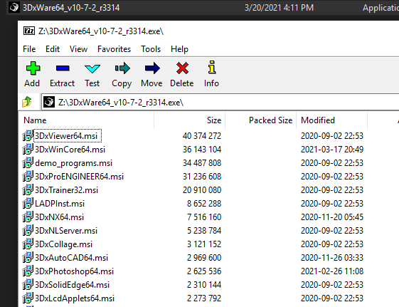

Sure, you can. Use 7-zip to extract the 3DxWare v10.7.2 driver, and install the *.msi installer. See the screenshot.
3DxWare 10.7.2 7-zip extraction.png (22.94 KiB) Viewed 2732 times

Thanks. Is it just those ones shown that need to be installed?

Mork73 wrote: ↑Thu Apr 15, 2021 1:10 am Is it just those ones shown that need to be installed?
It depends on what applications you have installed and what you want to do. Installing all is fine.
For more details, see the "Deploying individual .msi installers [...]" section in the Administrator Guide.
