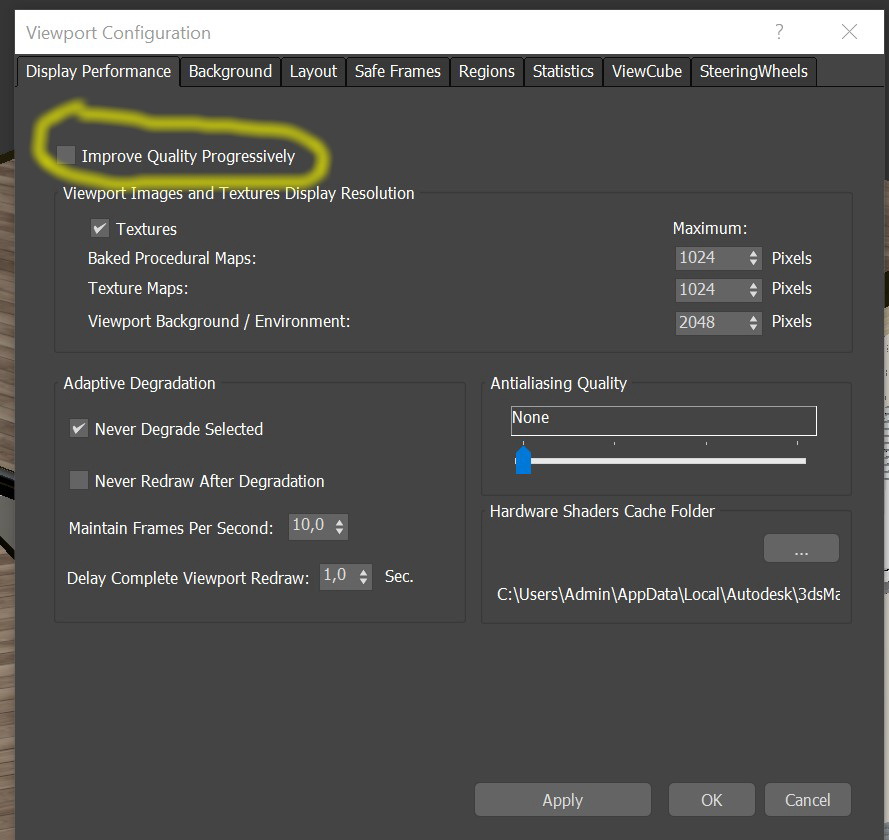

Re: 3dsmax 2022 viewport problem
I personally solved the problem by deactivating the check on "Improve Quality Progressively".
Which can be found by clicking on "+" and then "Configure viewports...".

Re: 3dsmax 2022 viewport jerky and locked to 60fps
This improves the redraw slightly, in that you don't have a lagging wireframe version of the model trying to catch up with the shaded version.
But it is still a 10x slower preview that just using ALT and middle mouse.
