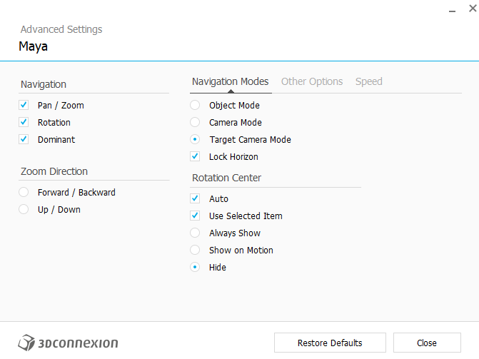

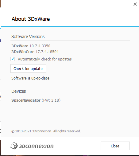

Space navigator constantly losing its rotation focus. When I restart Maya I can again rotate around selection, but after some time of work (bevel, extrude, etc) focus around selection is suddenly lost again, and I need to restart Maya again. It's annoying and it's breaking my workflow hard. Same with space mouse, and SpacePilot Pro although officially not supported anymore it still works with the latest drivers.
I have the latest driver 10.7.4.3350
Same with older drivers, but I decided to report this annoyment now.

The problem is that if you open maya and create few objects, select them one by one and navigate with 3D mouse it surely does work for a while.
After you have been using maya for maybe 15 minutes and you have more complext model the 3D mouse rotation center is not anymore either the currently selected object or its sub component like it should be and was in the beginning. So 3D mouse somehow stops using selected item as the rotation center.
When this happens you can of course still navigate in the scene with 3d mouse but it is very tedious and feels super heavy since after selected object is not used as rotation center, the user has to compensate the rotation offset in his mind and now has to also use movements just to rotate around the object. An experienced and seasoned 3D mouse user surely can do this pretty much automatically but it is not how this device is supposed to work.
the rotation center point has to be the selected object center or pivot, i dont know which one you use, for any fluent movement with 3d mouse.
When this bug appears and if you use mouse and keyboard navigation the centerpoint for mouse movements is absolutely correct after you press f (focus) key.
When this bug appears pressing F key or "FIT" key in 3d mouse surely brings the selected object to center just like F key with mouse and keyboard but it does not fix the rotation center for 3D mouse. The only way to fix this is to quit maya and restart and then it works for a while and gets broken again.
