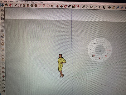

Hey there, I just recently updated the 3DxWare driver to 10.7.4 on Windows 10 for 3D Space Mouse Compact (wired USB). But when I started Sketchup Pro 2021, the radial menu shows a few standard inbuilt sketchup icons as flat lines. This problem is only evident with few icons whereas rest icons look perfect. The icons which show problem are - Line, Select, Paint Bucket, Move & 3D text. This is a very frustrating problem while working as I have assigned 8 shortcuts onto the both Buttons of the Radial Menus of the spacemouse. Kindly refer attached image.
Note all my softwares are running on latest drivers & I dont use any developer softwares. If anyone has any solution do update me!

Looks like a bug in our software. We're tracking this with reference WIN-887.
Thank you for reporting it to us, Kunal.

We expect to have a fix for WIN-887 in our next Windows driver update. We do not yet have a confirmed date for the upcoming release.
