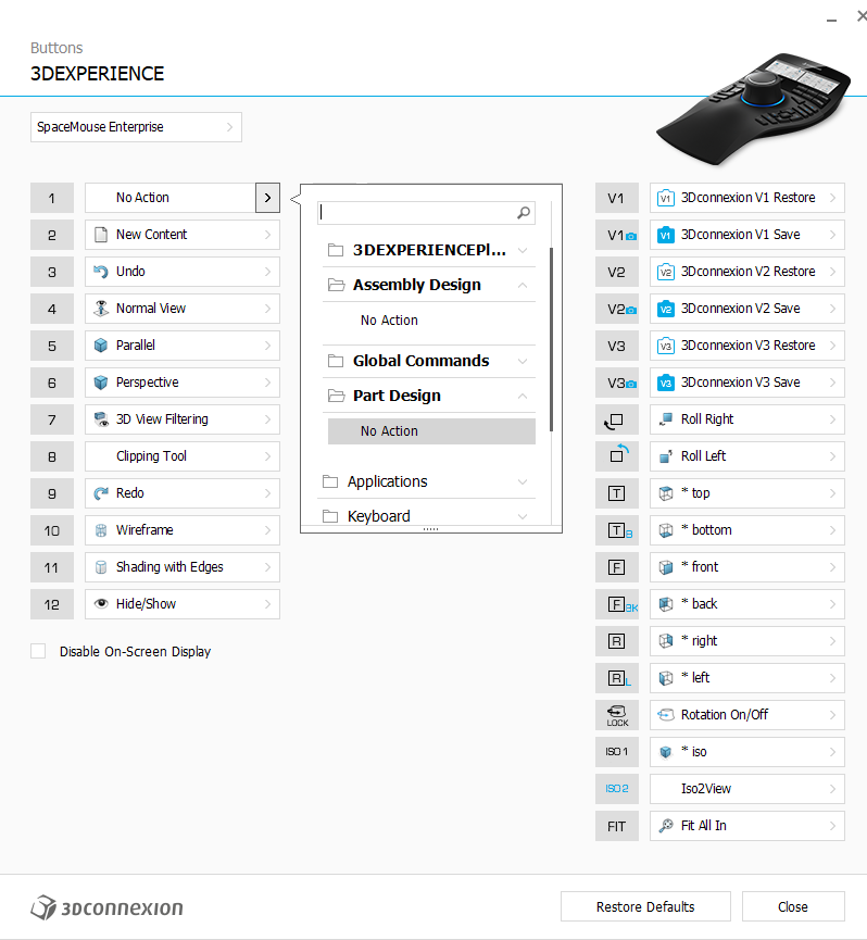

Hi,
My Enterprise does not detect function in 3D Experience. When I open CAD and the utility software for 3DConnexion, I do not anything under 3DExperience/Part Design (or any other application). How should I solve this?
With regards,
Jan

3DExperience version?
3DxWare driver version?
Most probably is that 3DExperience is partially supported.

By the way, you should check out the submenu of 3DEXPERIENCE in the fly-out menu of 3DxWare panel command mapping, if your version of 3DEXPERIENCE is supported.

Hi JanStr,
For 3D Experience, we only have support for navigation in which the display for part/assembly etc won't be showing within our UI as its not supported.
Also, if you talking about 3D Experience Solidworks connected then its not supported at the moment.
