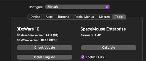

I am on build 3288 and on macos 11.0.1
I can confirm that the modifier keys on the Spacemouse Enterprise still. don't work. that i can tell.
when in zbrush shift should swap to the smooth brush .. keyboard shift keys work..
ones on the 3d mouse DO NOT.
were these supposed to work?
See attachment..

cjadams wrote: ↑Thu Dec 17, 2020 2:50 pm I am on build 3288 and on macos 11.0.1
We expect modifier keys to work in Keystroke actions (but not in "2D Mouse" actions) as of beta "11" (revision r3288).
Can you tell us what exactly you're trying to do in ZBrush?
Also, is the issue limited to that application?
