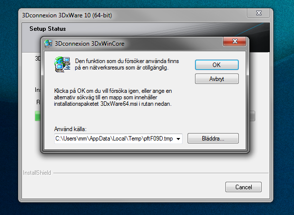

Hi,
I have the same problem, tried all the tips and tricks I have found in the forum.
Tried extracting the exe files, but the 3dxWare64.msi file is nowhere to be found.
Install can't find the location of the temp file. It's not to be found anywhere when searching manually. Seriously, a Clean install of windows is the only solution I have seen i the forum.

- Attachments
- Temp file not found
- 1.PNG (166.18 KiB) Viewed 4905 times

Hi MarcusM,
this is a special situation on your machine. Something with the installation got messed up. I have seen this before. I could solve the issue by entering the path manually. I copied the path and used the Browse button. I removed letter by letter at the end of this path (here: C:\Users\mm\AppData\Local\Temp\pftF09D.tmp)until I found a very similar directory (similar to pftF09D.tmp) with the same extension (.tmp). There I found all necessary files.
But in fact I assume that an older version that you had installed before is blocking the correct installation. Do you know which version(s) you had installed before? Do you still have the installer files? First install the previous version and if that works uninstall it. Then try the newest version of our driver.
You can get the msi files (we have many of them) by extracting the installer package with for example 7-zip. You get one exe that you have to extract/unzip again and this will bring all msi files. Let me know if you choose this way to install. I need to know what 3D mouse you have and with which software you want to use it. I can then tell you which files you need to install.
