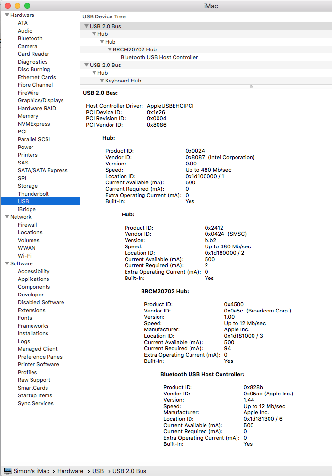

Just to make doubly sure, I uninstalled everything including the Sketchup plugin and started over. It all happened just as before except that I did not get the warning about the kernel file. I guess that is because I had already dealt with it the first time around. The attached screenshot suggests that it is all as it should be.
This time, I have not bothered with the Sketchup plugin as I wanted to make sure the computer and mouse were talking to each other. They aren't. If I try to open the trainer I get a brief image of something trying to load and then it gives up. If I open the Viewer, the Collage, or the Puzzle, I can use the SMC to move the cursor around but not to alter the camera.
Someone on the Sketchup forum suggested thatI might get joy paradoxically from loading an older driver, so I might try that. But as the latest driver is designed specifically for the SpaceMouse Compact, I don't hold out much hope.
I also attach a screenshot of my System and you can see that nothing shows under USB. The SCM is plugged into one of the sockets on the back of the Mac which is running OSX 10.13.5. It seems to me that the installation has failed to establish a link between computer and the SCM but it's not at all clear why not. Are you able to help further?
Simon
Simon

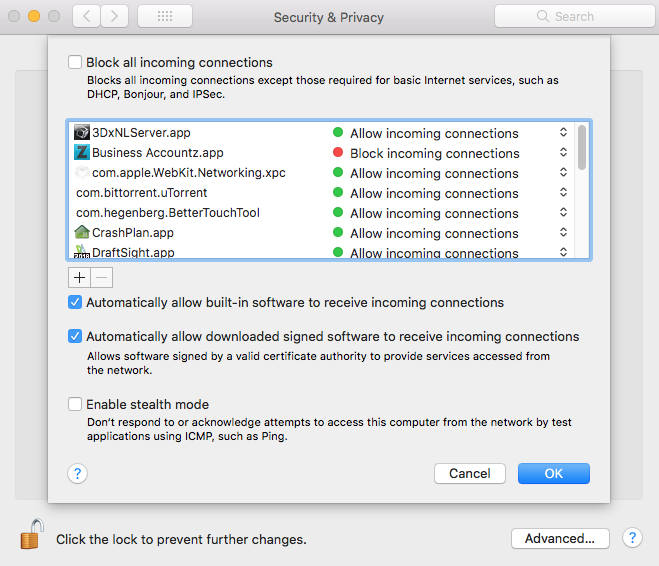

I had the same Problem after migrating from a late 2012 MacBookPro to a new 2018 Model, but it was solved easily:
1. Remove the driver
2. Reinstall the newest driver
3. Allow the System Extensions (as described here through Security and Privacy Panel)
4. If disabled, enable the firewall (makes no sense)
5. Open the Connexion Panel
6. Disable the Firewall
7. My SpaceNavigator was recognized again by the Connexion Panel and Fusion
