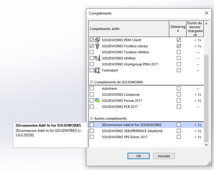

I run Solidworks 2017 on win10 and for some reason my old Space Navigator stopped working so I tried to update the driver but something got messed up in the add-in for solidworks. My SpaceNavigator works in the 3DConnexion viewer but not in Solidworks. I see the 3Dconnexion add-in in the extensions but I can't activate it. I tried to go to the previous version of the driver but I don't remeber the version that was working.
You said to look in the %temp% folder... is it in C:\Users\****\AppData\Local\Temp\3Dconnexion\Installation?
If it is, can I send you my files so you can tell me which version to re-install so I can uninstall it and start fresh?

jflachance wrote: ↑Mon Aug 21, 2023 7:54 am I run Solidworks 2017 on win10 and for some reason my old Space Navigator stopped working so I tried to update the driver but something got messed up in the add-in for solidworks.
Did you try uninstall whatever version of 3DxWare 10 you're using and then installing the latest (v. 10.8.15 as I write this)?
Version 10.8.15 should work fine with both SW2017 and your SpaceNavigator.
I did an uninstall so now I don't see any 3Dconnexion folder. But when I go in solidworks I see in the list of add-ons the 3Dconnexion add-on and it shows version 3.6.0.20358.
I looked in the old drivers section and the oldest I see is 3.16.3. Is it possible to get the 3.6.0.20358?

The add-in is not enabled. If you enabled it, everything should go back to normal.
I do not recall seeing an issue where the add-in was listed but could not be "activated".
Anyway and if you wish to use an older version, you can search the archive here.

ngomes wrote: ↑Thu Sep 07, 2023 12:45 am The add-in is not enabled. If you enabled it, everything should go back to normal.
I tried enabling it but it won't. It shouldn't even show since I uninstalled it and I can't see any 3Dconnexion folder on my computer. Is there somewhere else I could check to make sure there is not a deep buried folder or file that is still in there?
I realized though that the version showing there is the add-on version not the 3dxware version so I would have to have a way to know the version of the add-in in each 3dxware version... Do you know how I could do that?
I tried installing the newest software. I can see my 3d mouse and can work with it in the little viewer included in the 3dxware but I dont see it in solidworks and it doesn't add another version of the add-on in the list of add-ons in solidworks.

jflachance wrote: ↑Thu Sep 07, 2023 9:21 am a way to know the version of the add-in in each 3dxware version... Do you know how I could do that?
The "release notes" documentation has such information.
I do not recall seeing this sort of issue before but try installing older versions of 3DxWare 10 and see if you can enable the add-in. If the add-in is still present in the "Add-In Manager" after you have uninstalled 3DxWare 10, then something is clearly wrong. The application is picking up the add-in somehow (normally from the Registry), bypassing the implemented process.
