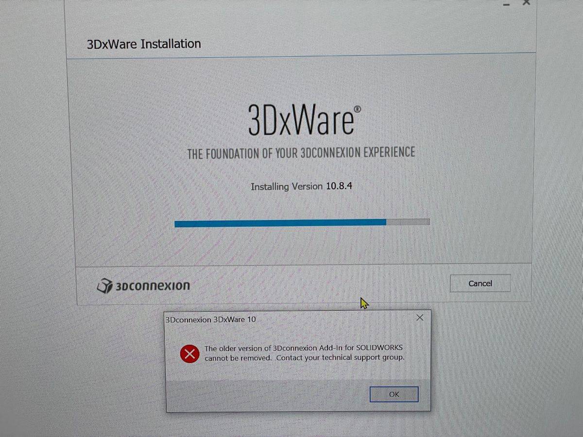

My first attempt at installing a driver failed because the installer said there was an older version that it couldn’t uninstall. That was with driver 10.8.4 which I later realized wasn’t compatible with my Space Explorer. When back through the registry and cleaned out more keys referencing 3Dx. Switched to the 10.4.3 driver. It stops at the point of installing the Add-In for SW,
“3Dconnexion Add-In for Solid-Works 2005-2016 installation failed.
Error: 1610
Do you wish to continue?”.
If I say yes it continues to load everything but the SW Add-In and of course SW can’t find the Add-In. No, and it backs most everything out. I’m installing as adim.

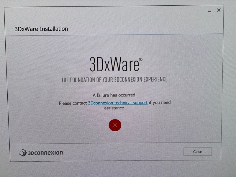

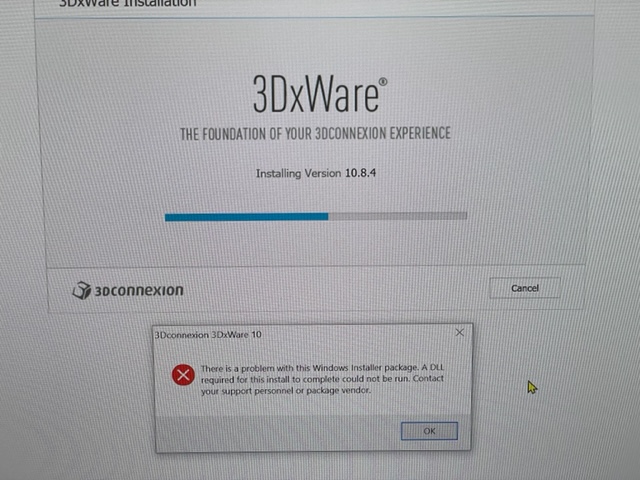

None of the versions of the installer work...
Dave V from tech came up with a bat file to fix the 1603 error, it didn't...
Here's the results from trying to install 10.8.4
My last attempt added this error to the others shown above... This after going back again and removing all traces of the driver and then running Dave V's bat file.
Regards,
Dave
Ps. To luping, if buying the latest and greatest SpaceMouse would fix this issue it would have been on order. The driver for it won't load either...

We had a look at the logs you sent over a private message.
For the old computer -- and as you pointed out, there are no installation log files. Did you try installing 10.4.3 yet?
For the new computer, we can see that the latest installation attempt failed because -- as you know -- an old SOLIDWORKS add-in cannot be uninstalled. As far as we can tell, the old add-in is included in version 10.4.3 of 3DxWare 10.
Please try installing the old version of 3DxWare 10 on the new computer (see link in one of posts above).

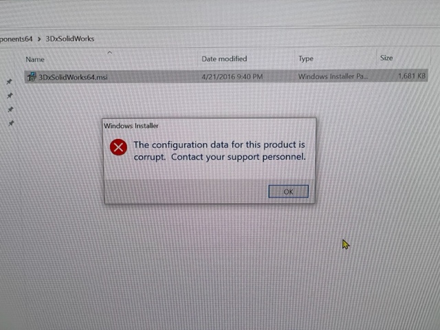

Dave_v
Posts: 11
Joined: Wed Jan 26, 2022 7:32 am
Re: SolidWorks add-in won't load
Post by Dave_v »
First time doing that, didn't know that was a thing.
Came up with this error when I tried running it.
Dave
ngomes
Posts: 3460
Post by ngomes »
Dave_v wrote: ↑Thu Jan 27, 2022 9:27 am Came up with this error when I tried running it.
Yep. The installation registration is invalid and the system cannot proceed.
